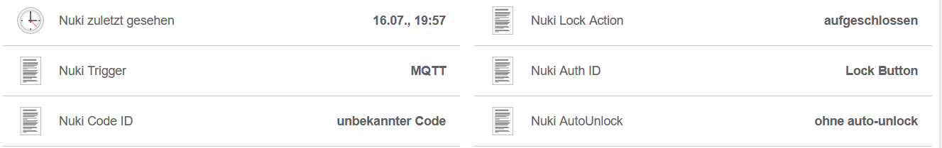

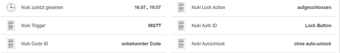

You can get a lot more of information from the mqtt api, for example subscribe to the lockActionEvent channel and then split the data into different items (sorry, transformation maps in German):
String Nuki_V_Action_LockAction "Lock Action [%s]" <lock> { channel="mqtt:topic:mosquitto:mynuki:lockActionEvent" }
String Nuki_V_Action_LockAction_LockAction "Nuki Lock Action [MAP(nuki_lockaction.map):%s]"
String Nuki_V_Action_LockAction_NukiTrigger "Nuki Trigger [MAP(nuki_trigger.map):%s]"
String Nuki_V_Action_LockAction_NukiAuthID "Nuki Auth ID [MAP(nuki_authid.map):%s]"
String Nuki_V_Action_LockAction_NukiCodeID "Nuki Code ID [MAP(nuki_codeid.map):%s]"
String Nuki_V_Action_LockAction_NukiAutoUnlock "Nuki AutoUnlock [MAP(nuki_autounlock.map):%s]"
rule "Split Nuki Lock Action Events"
    Item Nuki_V_Action_LockAction changed
    val String NukiLockAction = Nuki_V_Action_LockAction.state.toString.split(",").get(0)
    val String NukiTrigger = Nuki_V_Action_LockAction.state.toString.split(",").get(1)
    val String NukiAuthID = Nuki_V_Action_LockAction.state.toString.split(",").get(2)
    val String NukiCodeID = Nuki_V_Action_LockAction.state.toString.split(",").get(3)
    val String NukiAutoUnlock = Nuki_V_Action_LockAction.state.toString.split(",").get(4)
    Nuki_V_Action_LockAction_LockAction.postUpdate(NukiLockAction)
    Nuki_V_Action_LockAction_NukiTrigger.postUpdate(NukiTrigger)
    Nuki_V_Action_LockAction_NukiAuthID.postUpdate(NukiAuthID)
    Nuki_V_Action_LockAction_NukiCodeID.postUpdate(NukiCodeID)
    Nuki_V_Action_LockAction_NukiAutoUnlock.postUpdate(NukiAutoUnlock)
nuki_lockaction.map:
1=aufgeschlossen
2=abgeschlossen
3=geöffnet
4=lock'n'go
5=lock'n'go mit öffnen
6=2 x abgeschlossen
80=Fernbedienung
90=Lock Button ohne weitere Aktion
NULL=unbekannt
-=unbekannt
UNDEF=unbekannt

But now I’m struggling to implement a wife-friendly solution for the Overview-Page…
finally my questions:
How do you switch the smart-lock via openhab.
  • one switch with multiple actions?
    [“UNLOCK to ON” & “LOCK to OFF” vs. “LOCK to ON” & “UNLOCK to OFF”)
  • one item with two commandtopics?
I followed your link to the MQTT API Spec, but couldn’t find any commandlsist or something like this.
I do everything simple and without fancy graphical stuff, I am using Sitemaps with BasicUI:
String Nuki_V_Action "Nuki Action [%s]" <lock> { channel="mqtt:topic:mosquitto:nukivorne:lockaction"}
Selection item=Nuki_V_Action  mappings=["1"="aufschliessen","2"="abschliessen","3"="Tür öffnen"]
on Android:
on Windows Browser:
got it :slight_smile: thank you, for your help
