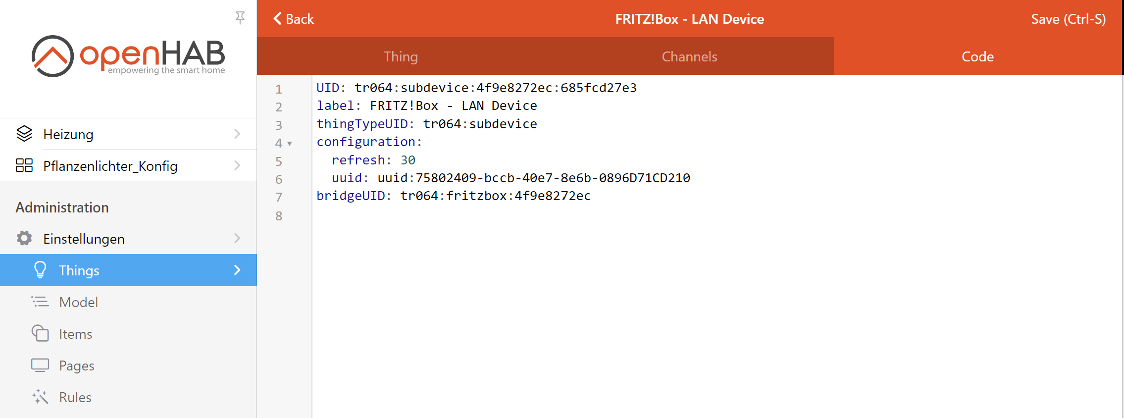

I am Talking about the Code behind a thing:
My assumption was that the code behind a thing would be the same, regardles of the location (GUI or file).
Understood - but it gets really complicated if you try to just use the UI to configure everything and the whole documentation is refering to the file based configuration :confused:
From your screenshot you have when creating a thing you have three tabs
Thing & Channels are a user friendly GUI to create a correctly formatted thing in the code tab.
Your assumption based on that screen shot is correct though if you go to the code tab and make changes. They will be visible in the thing & Channels tabs.
