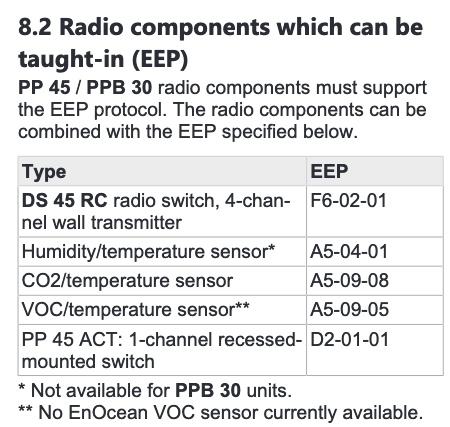

I’m trying to control a Maico PPB 30 RC ventilation unit with openHAB. The unit itself has builtin Enocean capability and as an assecory a “DS 45 RC” Enocean switch could be bought to remote control the unit. I think I need to emulate the switch to control the unit, as the EEP profiles supported by the unit, at least by the official documentation are somewhat limited:

But the actor part really drives my crazy at the moment. The DS 45 RC should be a 4 channel switch with a EEP F6-02-01.
