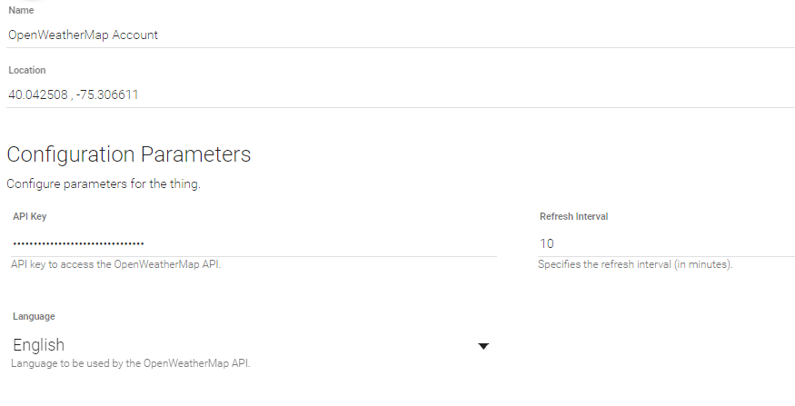

  • Installed the openweathermap binding and using PaperUI to configure the binding.
How do I format the location parameter? I’ve tried various versions of lat/long, city, zip code
Anyone figured this out?
Can it be done or do I have to use the file approach to create a Thing?

I entered the lat/long manually but I assumed it was incorrect because the Thing remains offline

If you enter your latitude, longituge in the settings section of the PaperUI, the binding should pick those up.
What do the logs say?
After searching, found another thread that directed me to create an additional Thing for Weather and Forecast.
After configuring the new Thing the Account Thing came online.
Seems to be working fine now
