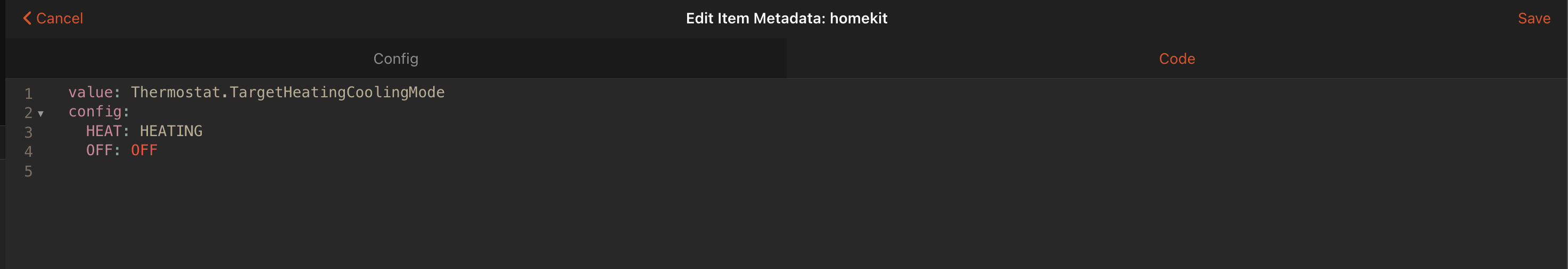

I’m trying to configure my HomeKit setup to support the Linear z wave garage door controllers, which have a set of states that don’t match the default per the HomeKit documentation. The docs state that the enum values can be overridden at the item metadata level, but I’m doing this all via the UI, and just can’t seem to figure out how to create those metadata records so that they work. I’m sure I’m just overlooking this in the documentation but cannot seem to find it. Can someone point me in the right direction? Here are the enum values I’m trying to configure:

I’m confused by this, as 255.0 is clearly an expected value per the log entry itself. Do I need to modify this Number item in some way to remove the decimals? My config looks like this:
The quotes seemed to fix it! I don’t fully understand why that would work, seems like a bug, but I do have one of the doors working properly now. The other is failing it’s secure Z-Wave pairing so that’s another but separate issue.
