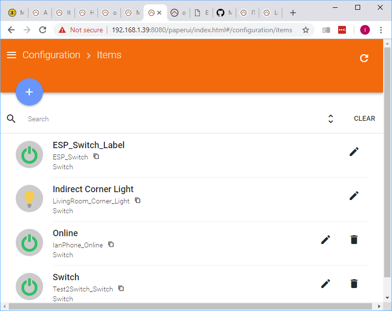

I don’t see this item appearing anywhere in Openhab which I can monitor or interact with it except in “Configuration>items”
and there nothing configurable about it!

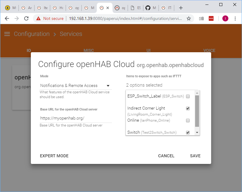

Actually I can see it in in the list of openHAB cloud exposable items:
But it cant be “discovered”.
