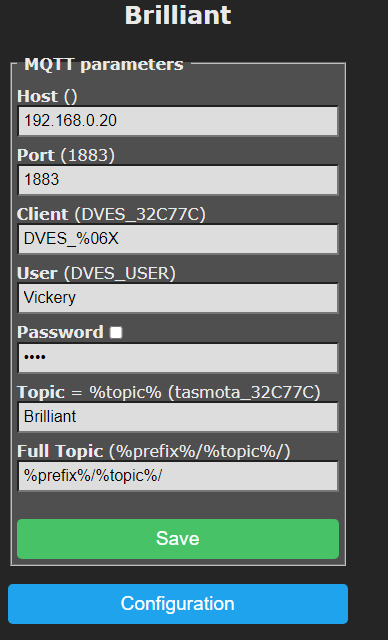

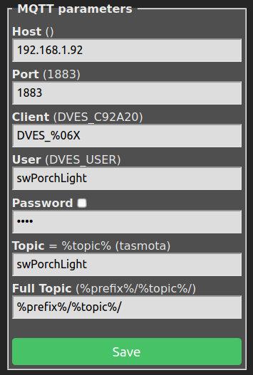

Can you take a screenshot of the MQTT parameters page from Tasmota, and paste it into a reply. We can go from there. It should look something like below:

OK, so your thing file could look something like this:
Bridge mqtt:broker:MosquittoMqttBroker "Mosquitto MQTT Broker" [host="192.168.0.20", secure=false]
	// Switch Light
	Thing mqtt:topic:Brilliant "Light switch" {
		Channels:
			Type switch : switch "Power Switch" [
				stateTopic="stat/Brilliant/POWER",
				commandTopic="cmnd/Brilliant/POWER",
				on="ON",
				off="OFF"
then an items file could include:
Switch sBrilliantSwitch "Brilliant Light Switch"  { channel="mqtt:topic:Brilliant:switch" }
and the sitemap could include:
Switch item=sBrilliantSwitch label="Brilliant Light" icon="light"
That covers the basic on/off for the light. I notice the MQTT payload includes dimmer and colour - is this a lightbulb? This link may also be useful, as it includes an example channel setup for the colour and dimmer:
EDIT: Also, make sure you have the MQTT binding installed (not v1), and the JSONPath transformation (for the dimmer and colour stuff). You can do this via the PaperUI.
  • PaperUI → Add-ons → Bindings → MQTT Binding → Install
  • PaperUI → Add-ons → Transformations → JSONPath Transformation → Install

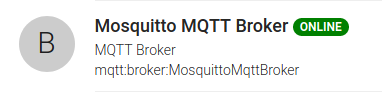

As @rossko57 says, check that your broker connection works. In addition to looking at the logs, you can also use the PaperUI.
Go to Configuration → Things and scroll down until you find the MQTT broker. It will look very similar to mine:
If it says “ONLINE” then at least that bit is working. If it doesn’t you need to double check the broker settings in the things file, including whether you need authentication or not (dependent upon how you setup the Mosquitto broker).
Yes the MQTT Broker is online. Checked using Frontail that the items changed values, no mention if the data was published.

I have a switch called swPorchLight, so subscribing to that topic and switching the openHAB power switch on and off shows the following:
pi@raspberrypi:~ $ mosquitto_sub -d -t +/swPorchLight/#
