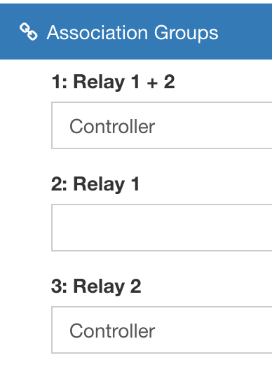

Actually, there is a way around that, even if really poor; and involves setting the association group (see image below). When you set Relay 1+2 it will send the event for endpoint 0; when you set Relay 1 it will send for endpoint 1, and so on.
The problem is that since around 2.5, there the first association group is forced to the controller. Usually it is the lifeline, so it’s actually a good safety net. But for this device, this is not really working.
Again, I am not sure that supporting this weird behavior is really worth (unless it’s just a matter of quick configuration); but it would be nice to have some alternative way to configure the switch.
Screenshot 2020-03-04 at 20.11.12
