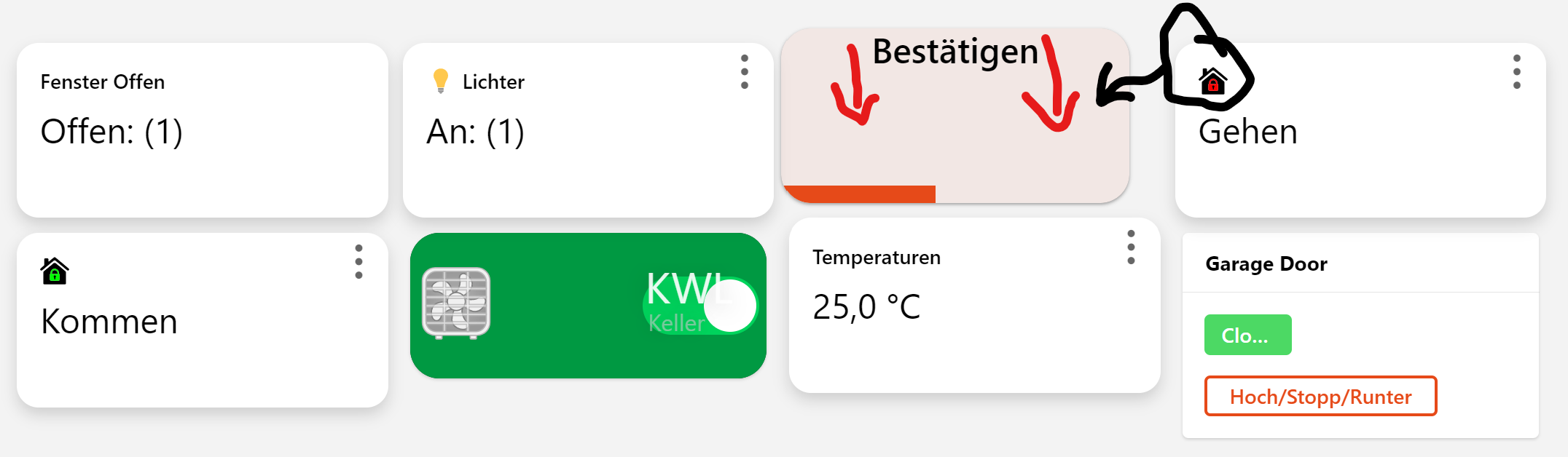

Hi Justin,
many thanks for this UI Widget . I also have some extreme useful but dangerous buttons on my pages and this widget will help.
I do have a question on the style. I would like to have the button the same size look and feel as my other label cells and the text appearing on the horizontal and vertical cantered. I have started to change your yaml code and had to use a absolute height as otherwise the button size did not change. The rounded corners I found some tips to use the border-radius. But all my attempts to get the initial text and the confirm text vertically aligned failed :frowning:
  default:
    - component: div
        class:
          - cd-button
        style:
          --countdown-background: =props.style && props.style.background
          --countdown-bar-color: =props.barColor
          --countdown-duration: =`${(props.countdown || '10')}s`
          height: 120px
          border-radius: 20px
          position: relative
          text-align: center
          vertical-align: middle
Also tried to edit not the default slot but the two oh-button yaml code directly as they seem to “overlap” each other. From the way I have written this you can probably guess that I am not a CSS expert…
Any quick idea or suggestion you have in mind to achieve this. For better illustration below a picture. Ideal case I also ike to have a icon displayed but this is not a must have
bkumio
Vertical alignment with css is sometimes tricky, IMO. The best advice is always to let the css do as much of it as possible and not try to force it. What I mean in this case, is don’t set any of the child element heights to an absolute value. Let them all just be the same height as the root component with height: 100% (add that to the style of the cd-button <div> and the two oh-buttons). Then all you need to do is set the height of whole widget using the style parameter when you add it to your page.
Now you can easily control the height of the whole widget, but that doesn’t fix the alignment issue. I think here, I would just rely on flexbox for the alignment. That will require, I believe, the fewest adjustment. Those adjustments (which should be applied to both buttons) are:
  1. Move the text from the button definition into a Label in the buttons default slot (this will render the text in a <div> element instead of the default <span>).
  2. Set the button to use flex display.
  3. Set the flex pattern to use the column (up-down direction) and then to center the child elements
For example, for the confirm button, that would look like this:
          - component: oh-button
              actionPropsParameterGroup: confirmed
              class: =(vars.countdown && 'cd-fade')
              clearVariable:
                - countdown
              style:
                visibility: hidden
                height: 100%                  <-- Make sure button is always full height of the root element
                display: flex                 <-- Set to use flexbox for displaying child elements
                flex-direction: column        <-- Align the child elements in a column
                justify-content: center       <-- Start that alignment in the center of the button
              default:
                - component: Label            <-- Make the button text a `<div>` child element
                    text: =props.confirmText || 'Confirm'
Edit: If you stretch the height of the widget, the countdown bar at the bottom will also increase in size. If you want it to have an absolute size, for example, 4px then you have to change the background-size definition in the cd-fade style declaration in the cd-button component:
background-size: 100% calc(100% - 4px), 200% 4px;

This worked, many thanks
I did not had to use your #1 suggestion to move the button definition into a label default slot. The change #2 and #3 in combination with the widget style parameter and and the usage of height: 100% did already rendered both texts in the middle the way I wanted. Don’t know if this is by accident on on intention.
This CSS stuff is not intuitive/easy to read if you are not a developer but I am getting there slowly.
As well the hint for the bacground-size was useful to experiment with. Didn’t needed at the end as it looked good for my box height of approx. 120px
I do have one final question. The standard labels do have a sort of semitransparent blurred box-shadow style. Any idea how to achieve this too? On w3schools.com I do find some examples on this like : box-shadow: 5px 10px 8px #888888 . But I don’t know how to translate this into this Yaml code at the right line(s)
Edit: reading Yannick´s reply its no wonder I struggled with adapting a masterpiece type of example :slight_smile: . Thanks for all your support and patience guys.

I tried to learn something by myself and exchanged the divs with oh-button-cells and mixed some config from the div and my cell config… it shows something but I always get the confirmed popup text which I added as Action feedback without any countdown…
this is my approach in a test widget so far
uid: TestButton with Confirmation

The basic idea is this: The action of the primary button just increments a variable (if the variable doesn’t exist then it substitutes 0 and increments to 1). When that variable is a non-false value then the two different buttons get new css classes. Those new css classes trigger a css animation that runs for the configured amount of time.
The most important part here is that in both animations the css property animation-fill-mode is not set so it retains its default value of none. This property determines how an animation affects an element before and after the animation runs. A value of none means that the animation is not applied at all except when it is running. So, as soon as the animation is over, the two button return to whatever css properties they had before the animation was triggered. The animations then switch the visibility of the two buttons: with no animation the primary button is visible and the confirm button is not, when the animations are running the the confirm button is visible and the primary button is not.
If the confirm button is pressed while it is visible, then it does two things: it runs whatever the actual configured action is and it clears the variable set by the primary button (thus removing the css classes and consequently ending the css animation).
The ‘key’ property is required on one of the parent elements to handle the case where the confirm button is not pushed while it is visible. In that case, the animation has run its course and ended so that the primary button is visible once again. But the variable is still non-zero so both buttons still have their css classes applied. Incrementing the variable again won’t change that and so wouldn’t cause the animations to restart. But, changing the variable will change the value of the key property and when that value changes that element and all of its child elements will be redrawn, this does cause the animation to run again, because it’s as if it has never run in the first place.
The countdown bar is just a feature of the css animation on the confirm button itself. The button just has a background that is twice as wide as the button and where the bottom is one half transparent and one half colored. During the course of the animation, that background slides across the button so you see the boundary between transparent and colored background sections as the leading edge of the “countdown bar”.
Partially. Some aspects of this are generic enough that you could adapt them fairly easily to an oh-cell. Others unfortunately might be trickier.
You have to have the two different buttons (or in your case cells). There is just no way for the oh widget components to know when a css animation is running or not so there’s no way to make a single component aware of whether it should be in the base state or the confirm state. And, because you need the two different components, you need to have at least on parent element to contain them and hold the css directives that apply to both of them.
You don’t necessarily need the two nested div element as parents, that’s an artifact of needing ot be able to pass the style object from the config to the widget while also being able to set some style parameters directly. If you’re not try to set this up with a configurable style then you can get away with only one parent element.
The C in css stands for ‘cascading’ which refers to the idea that a css setting in one element will always apply to all of this child elements unless it is specifically overridden by one of teh child element’s own settings. So, because you want the css of the classes and animations to apply to both of the child cells you would need to have that stylesheet in a parent of those two cell. If you are putting many of these on a single page, then instead of having the css directives in the stylesheet of each parent element, you can define a single stylesheet for the page that sets of the classes and animations. That would have to be true on every page you put one of these on however.
You might be able to get away with defining the key on each of the two cells separately. But there’s no reason to since you still must have the parent element. It’s best to just leave it there.
This is easy if you are using the two different cells. The “confim” cell just has whatever the override text is in the footer. And then, if you don’t want the countdown bar, you don’t need any of the background parameters in the classes or animation keys. But again, because you cannot integrate the css animation status into the widget expressions there would be no way to do this just with an expression for the cell footer on one cell.
Right now your widget structure is:
f7-card
  oh-knob-cell
    oh-knob-cell <-- css styles applied here
  1. you do not want one cell as a child of the other
  2. if your css settings are on the lowest child element then they cannot apply to the elements above
Thanks a ton! I think You covered mostly everything in your explanation… I now understand more how it’s supposed to work, and will give it another try tomorrow and see how far it’ll take me without further help :wink:
Thank you so much for everything!
What type of element would you choose for this - am I able to use the styles in a f7-card?
I chose a div element because that will have no additional styling applied to it. It is there to hold the styles that should apply to the button, and it shouldn’t do anything else. Any of the main f7- components (card, block, row, etc.) are just rendered as div elements but with lots of additional f7 styling already applied to them which you don’t need. So, just cut out the middle-man and use the div.
Whoo, I think I give up on this… I tried to use the browser to debug the css but there are so many classes and styles applied to an oh-knob-cell that it’s nearly impossible for me to work around these.
Maybe I am able to style divs to look like knob-cells and apply your functionality to it, but as you mentioned before there is way too much css in f7 or oh stuff… when I find a way to get this going I will post an update.
I really love and keep using this one, thanks @JustinG
Recently I noticed that the button is fixed size or at least too small for longer text labels
(I’m on 5.2M4).
Could you do anything about that please?
I’m glad to hear it’s getting use.
To be honest, I don’t use it anymore because the same function is now built in to any OH action:
That brings up a dialog instead of the countdown timer, but the effect of requiring a second click is the same. So, I’ve switched over all my uses of this widget to buttons with that confirmation config. That’s why I hadn’t noticed the change in styling with the recent updates.
But, if you prefer this timed countdown to the dialog, then let’s get this fixed up. The fix is pretty brief. You just need to add width: 100% to the style of both the second div element (the one with class cd-button) and also add it to the style of the first button element (the one with the “Confirm” text). You can make those changes in place easily enough, but I’ve also updated the original so you can just re-download it as well.
