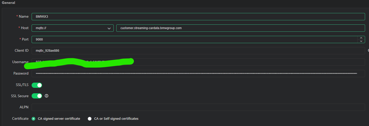

  2. Create a MQTT Broker and Generic thing
    2.1. Create channels in the Genering thing for your items
  3. Create the JSRules to refresh the tokens and update your Broker thing
  4. Create more channels :slight_smile:

If you also installed the BMW_ID_Token_Updates.js your MQTT broker thing will be updated with the new ID Token.
Please note that you need to have the MQTT broker thing for this to work.

2. openHAB MQTT broker and generic thing
Now that you created the Client_ID and tokens, we can create the MQTT broker and generic thing.
I did this through the main UI.
New thing → MQTT binding → MQTT broker
  1. Set your desired UID, i just used bmw (mqtt:broker:bmw)
  2. Set a laben that works for you, i used ā€œBMW MQTT Brokerā€
  3. Broker hostname = customer.streaming-cardata.bmwgroup.com
  4. Port = 9000
  5. Secure connection = Yes
  6. Confirm hostname = Yes
  7. Protocol = TCP
  8. MQTT Version = 5
  9. Service quality = atleast once (1)
  10. Client-ID = Your Client_ID or empty (openHAB would create a Client_ID for you)
  11. Username = Your gcid / username
  12. Password = Your ID_Token
  13. Discovery = No ← Important!
  14. Save

Thanks for this new connection. I did the steps and got all the details but can’t get it working with MQTTX. I get the bad username or password. I used for Password the id_token what you mentioned but not sure about the username. I tried different options but also the username shown at the CARDATA-STREAM but with the same result. Any suggestions?
Your username is the gcid from the last step.
I have MQTTX working, the broker is online and I created a things file and added the items. I also set the org.openhab.binding.mqtt.generic in trace mode but I don’t receive any data. How to debug this?

You wont receive any updates unless your car is sending new data.
You can force an update through the MyBMW app, just send a command like lock or light to the car.
Yes I know but expect when MQTTX receives date I would also see date in OH.
You canā€˜t have MQTTX and openHAB broker online at the same time with the same credentials.
