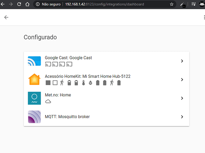

Hello everyone, I spent a few days trying in various ways found on the internet how to connect the Mi gateway ZNDMWG03LM model to OH, I didn’t find anything that works. So I came across some tutorials installing the gateway on Hassio. In a few minutes I installed the Hassio on pi4 and add-on homekit accessories.
It was amazing how it automatically found the gateway and it was just necessary to put the code in the homekit and everything worked perfectly.
I ask, would OH not have an add-on with this wonderful functionality found in Hassio ???
I was really surprised how something so difficult to work with OH was so easy to use in Hassio.
Xiaomi sensors are excellent options, cost and durability of batteries. It would be wonderful to be able to use the gateway at OH.
A print of the hassio:
