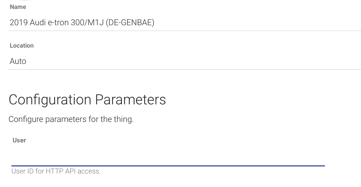

I am running openHAB 2.5.5 - binding installation perfectly working. CarNet Account for my 2019 e-tron 55 is online. The channels appeared in the log. The car was added as a new thing and I could add the relevant items (mainly charging state and range) in an items file. The items get an update only once - now the car is offline showing a Communication Error in the log. Maybe I am missing something…what should I put into the USER field:
Tried the myAudi login name, VIN of the car, PIN of the myAudi APP - still the same error.
OK - deleted the car - searched for it again - now back to online. Items are coming in and updating roughly every 10 minutes.
