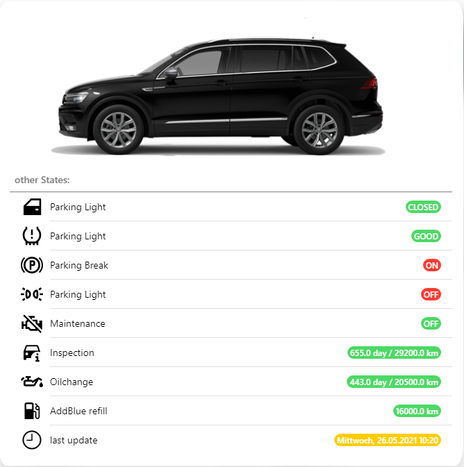

Also check-out @hmerk 's Widget for the OH3 Main UI

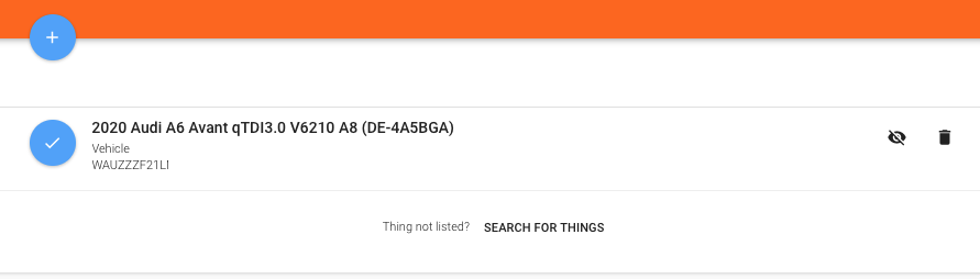

  • Run the discovery from the Inbox, this brings in the Vehicle things

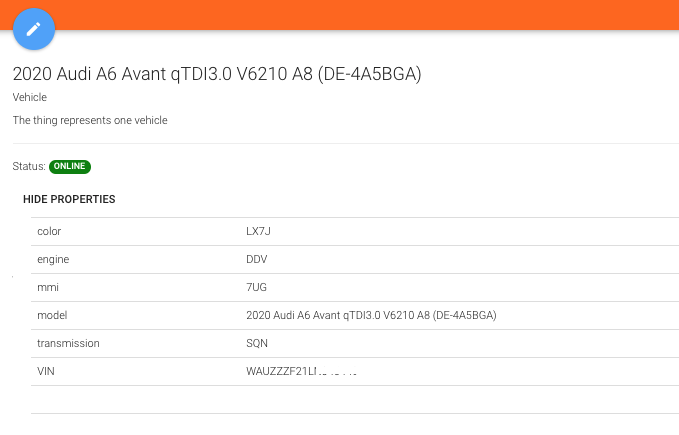

I quickly replaced the jar via my phone and the thing is online now (i have to look in the logs to see if this new jar solved it, of if it was a matter of time). I was also able to add the vehicle. I’ll have a look later today to all channels.

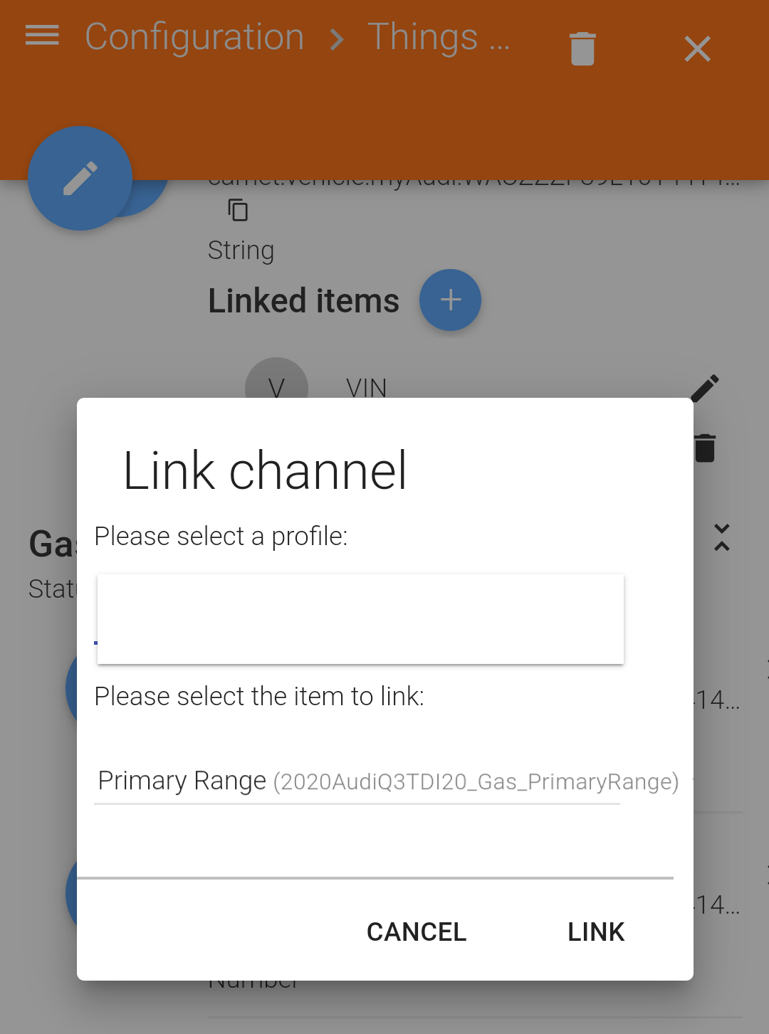

Quick look to the channels: I need to select a profile, but the drop down is empty. The channel for VIN was working out of the box. I normally use textual config, so maybe I’m missing something (Will try text config this evening)
New jar seems to be working. CarNet Thing was online, car has been discovered and appeared in the inbox and has 1 channel for VIN. In the Logs I see many more measurements, like tire pressure, window / door lock status etc.
you beed to reload the page, those channels are created dynamically :wink:

The vehicle is configured via paperUI and the items by textual config (can’t select profile in paperUI, and in textual config, this is not an issue)
