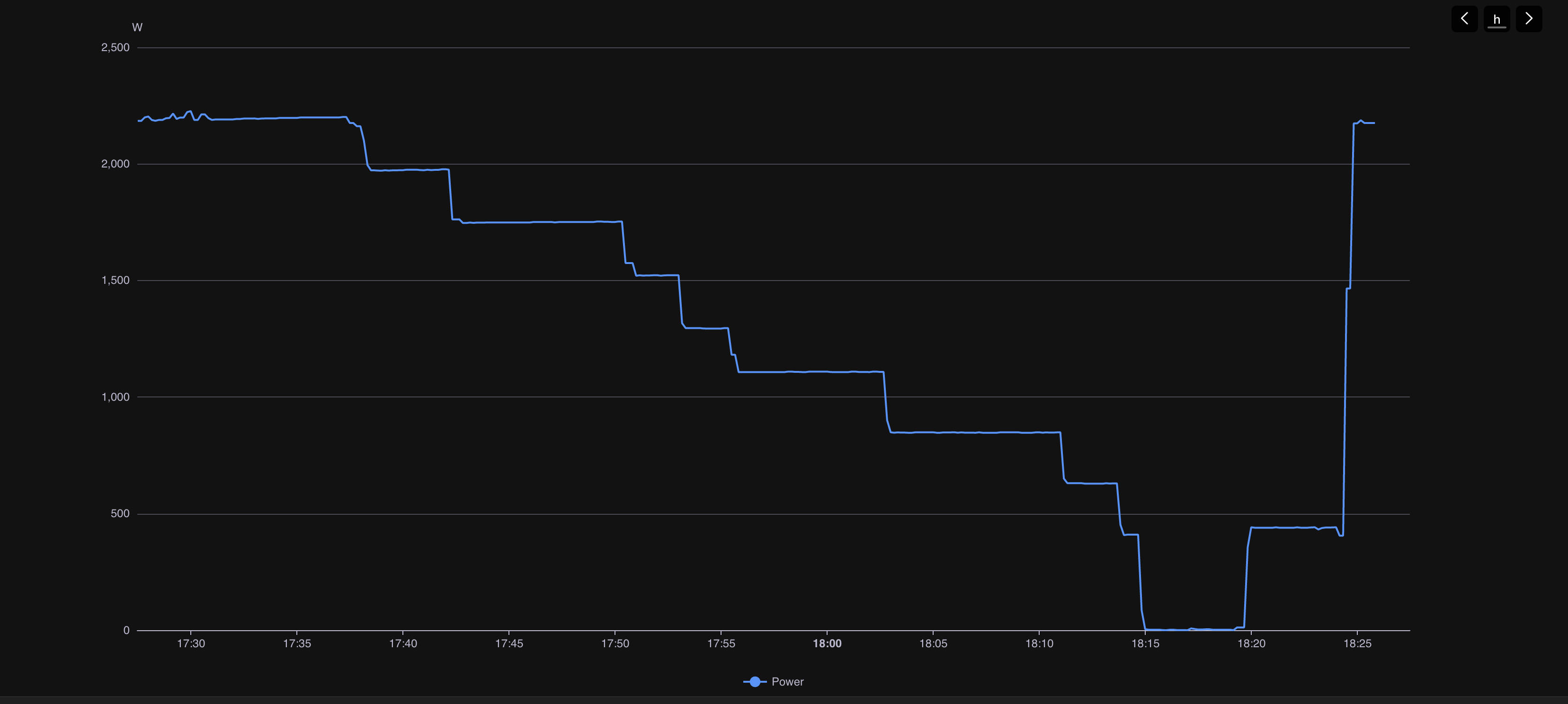

Great news on charging electric cars for load-balancing/self-use optimisation:
The SetMaxCurrent is again working successfully with this version: (updated · markus7017/myfiles@3ae9308 · GitHub)
The original VW “We Connect” App only allows for a few different settings on the max Amperage. But using this API and Binding directly it is possible to use much more settings. It is possible to tune the power on 1Ampere steps all the way to 1.
I have validated the actual powerdraw with a PlugWise SmartPlug and can verify the settings are really being used by the car:
Still have to check reliability of the setting below 5A.
Thanks @markus7017 for your work on this binding! Saves my from buying a much more expensive charger and allows for tuning to even lower power levels. (the protocol from charger side can not go below 6A)

Maybe it was not clear from my post by I tried different numbers and was pleasantly surprised that all values between 2 and 16 Amps seams to work. That is a much bigger range and better granularity than I expected.
