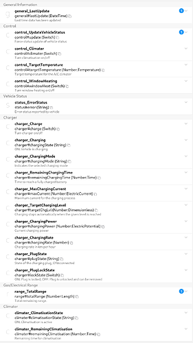

So here is the first update:
after unlinking and deleting all items for my actual id.4 thing and delete the thing itself my ID.4 appears in the new things overview immediately. I added it and these channels will be available also in a very short time: (I write this, because discovering Cars and Channels uses a long time in the past.)
So some known channels from before are missing.
Analysing the debugging information from console i get this:

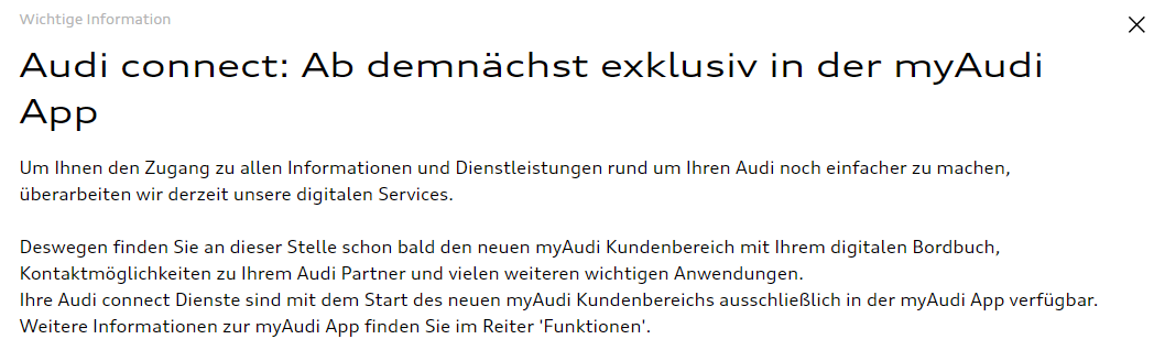

Because when I access the myAudi website, the following message is displayed:
merry christmas!
Ralph
