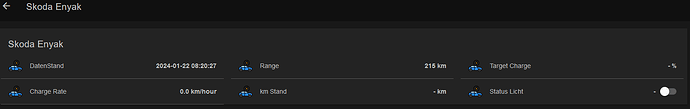

Odometer for my Skoda Enyaq 80 fails both with
org.openhab.binding.connectedcar-4.0.4-SNAPSHOT-20231223-2.jar
and version 4.0.2. SoC, position data, and many other data are ok. Did not try to write anything, like Set temperature. Any ideas?

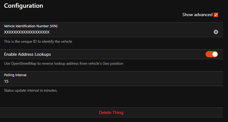

May be a stupid question but when you added the channels die you activate the “show advanced” checkbox? I’m not actually sure what the thought was why that is advanced but it just is.
Sure, I used “show advanced”. I appreciate your efforts to keep this binding running. As SoC information got unreliable as well since some days, like @martin1338 in post 1301 I now switched to a solution where Home Assistant supplies a “binding” Skoda Connect and MQTT DiscoveryStream delivers sensor data to my OpenHAB broker.This approach seems especially attractive. Now, both HA and OH can complement each other.

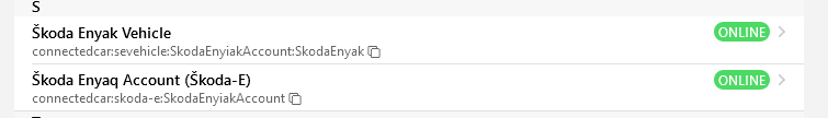

I am also trying to get my Skoda Enyak into openHAB.
But it looks like, that the binding dioes not update at all.
Based on the data it did an update when I installed it.
This is how my Things look like
both are online, but no update on the channels-
Any idea what could go wrong during the installation of the binding?

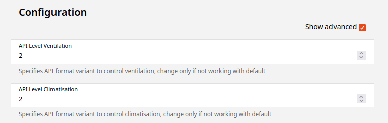

Climaters are in general a bit fragile. The connect Thing has a configuration for API
I cannot tell you what the right one might be for your car. AFAICS 1, 2 or 3 are valid API levels you could check out.
I don’t have these settings in the vehicle thing configuration:

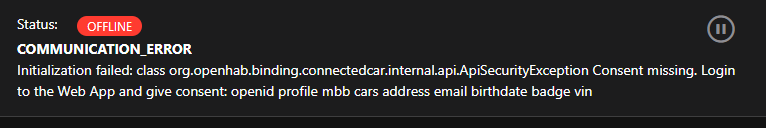

Ah, okay, you use the “Volkswagen Account CarNet”. This isn’t working for me (I’m from Germany):
So what vehicle type do you have set up then for your Golf?
I have
SEAT Connect Account (Carnet) for my Cupra Leon PHEV
and
myAudi Account (CarNet) for my Audi Q5
And I’m in Germany.
So Volkswagen CarNet does not work at all anymore?
But on the other side the error message you posted suggests a solution. Not sure about the details but apparently there is just some sort of consent required being done somewhere?

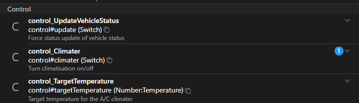

These are the control channels at the WeConnect Thing:
