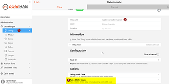

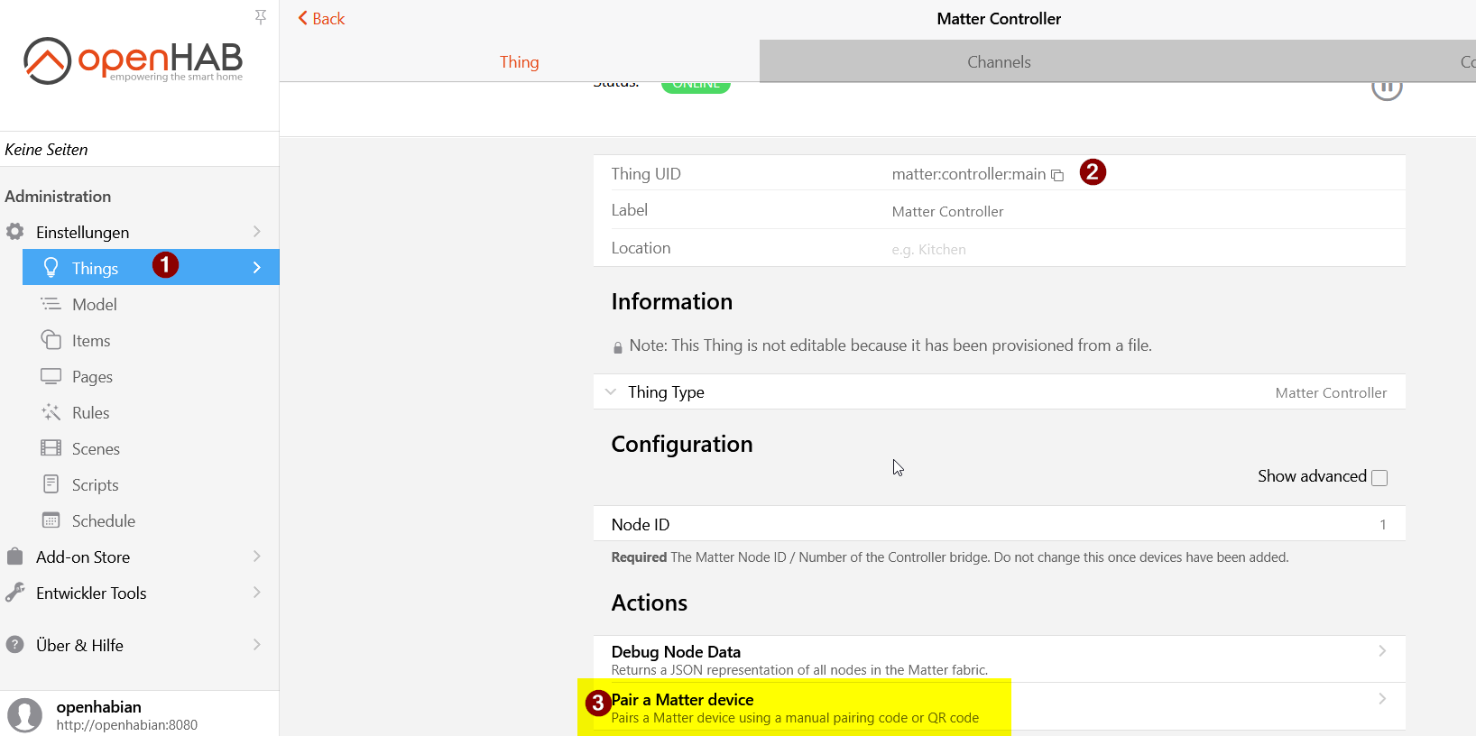

Matter device pairing
Now comes the most difficult part: you have to pair the devices.

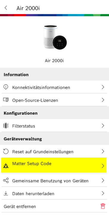

First, you need to find the Matter setup code in the Bosch app under Devices.

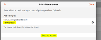

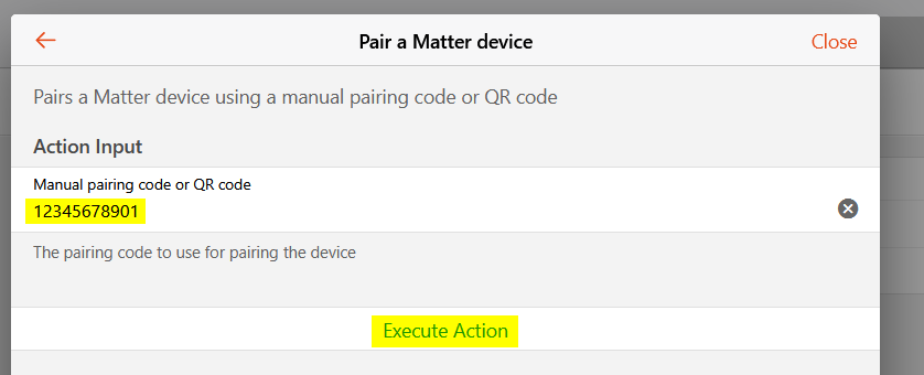

You must pair the code displayed in the app using the Matter controller thing.
It is important to enter the 11-digit code WITHOUT hyphens.
If it worked, you will receive the air purifier as a new Thing.
Thing matter:controller:main [ nodeId="1" ]
Thing matter:node:main:7819818200003524007 (matter:controller:main) [nodeId="7819818200003524007"]

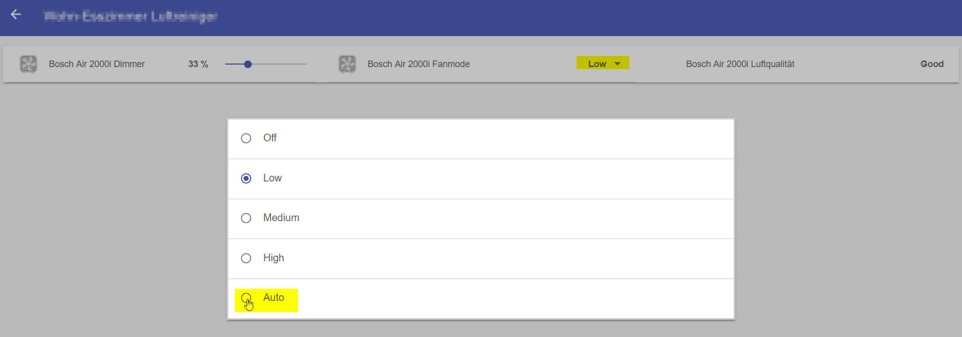

Now you can easily control the air purifier using the following items.
The main control is via the “fancontrol-fanmode.”
Dimmer BOSCH_AIR_PURIFIER_DIMMER    "Bosch Air 2000i Dimmer"        <fan>   (LivingRoom)  {channel="matter:node:main:7819818200003524007:1#fancontrol-percent"}
Number BOSCH_AIR_PURIFIER_FANMODE   "Bosch Air 2000i Fanmode"       <fan>   (LivingRoom)  {channel="matter:node:main:7819818200003524007:1#fancontrol-fanmode"}
Number BOSCH_AIR_PURIFIER_AIRQUALI  "Bosch Air 2000i Quality"          (LivingRoom)  {channel="matter:node:main:7819818200003524007:5#airquality-airquality"}
