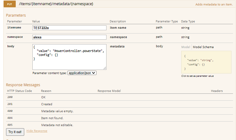

In the rest api did you put a command in the body of the message like ON
It looks like you are using Paper ui to configure everything like items. If this is try you need to add metadata to your items
In your rest docs add like this
