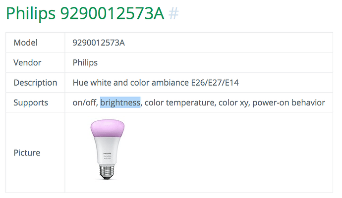

The Supported devices page I already discovered. Lets look at e.g.: Philips 9290012573A control via MQTT | Zigbee2MQTT
No where is documented this: { "brightness" : 50 }

Where are you seeing this?

January 3, 2020, 5:41pm
16
The link posted above shows brightness as being supported. That why I was confused about { "brightness" : 50 } comment.

Why does it say, that it supports brightness?
