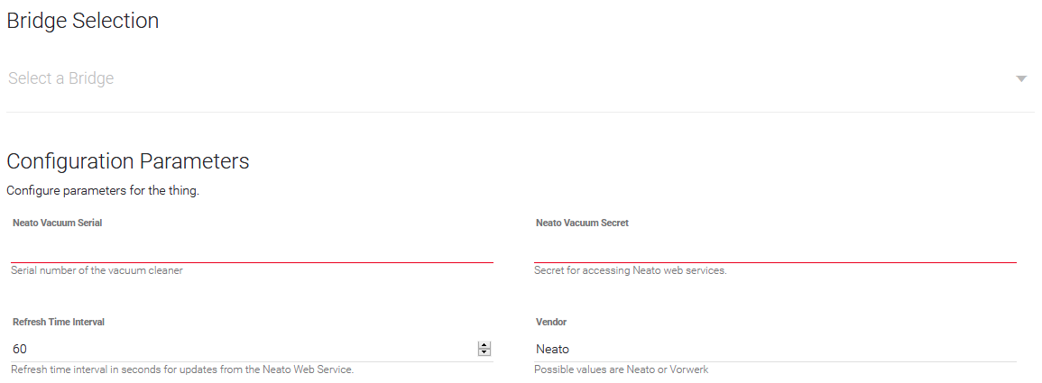

Hi Pavion,
seems the addon is broken.
I can enter my login but after that I got stuck. I can’t remember I entered anything of those credentials by myself.
[Yes I can choose a bridge]
Can you help? Enter anything lead to communication errors!
Regards
Hi @tailor09
My setup is up and running…
Normally you would create a Bridge first, enter your credentials and a proper vendor and save it. After that you can go to your inbox and discover your vacuum automatically.
If it fails, please check your OH and binding’s versions.
BR Pav
