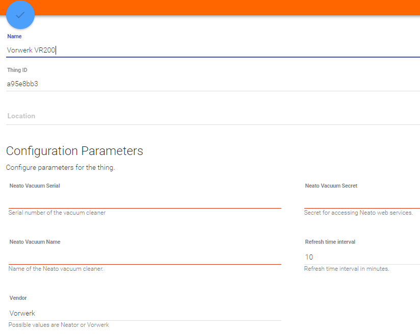

Hello all,
tried to connect my VR200 using the modified binding described above. Auto discovery does not work. To add the thing manually is possible but then after setting the robot supplier to Vorwerk the thing configuration screen (PaperUI, see below) requires 2 more values instead of none as described above before the thing can be added:
  1. Serial, is this the serial number of the machine?
  2. Secret_key, how can i get this?
Are serial and secret required or not? Every input leads to a response that the adress is wrong?
Also recognized that the http:// adress for the Vorwerk cloud server which is implemented in the binding is different to the one i see if i activate the Vorwerk skill in Amazon Alexa. There it is beehive.ksecosys.com instead of nucleo.ksecosys.com/...as within the binding. Is this model/firmware dependent or might i have an old version of the binding? Use openHAB2.4.0, build #1346 under Windows10.
Does this binding actually work out for anybody? Appreciate every hint.
