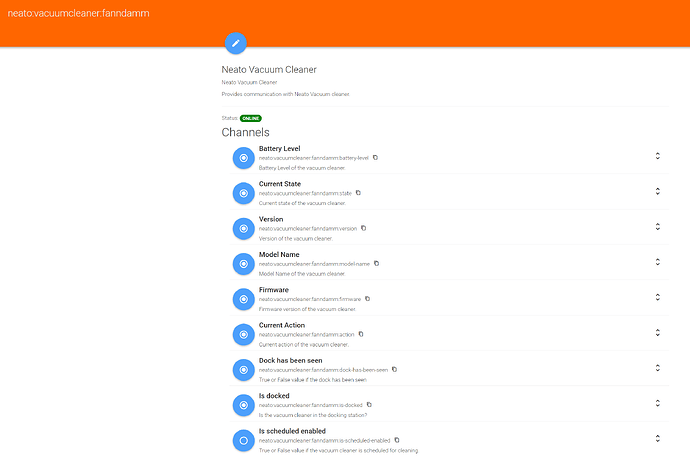

Hi all!
Still have some things that should be fixed, unfortunatly - time is running too fast here :slight_smile: But - if you would like, here is the jar file for the binding as of today. One thing that remains to be fixed is that the binding starts the scan just before it has gotten the configured values (under binding configuration in PaperUI). The result of this is that the vacuums does not automatically gets discovered and added to the inbox. However, they will be if a manual scan from the inbox is started - so I guess it’s not a big problem.
So:
  1. Add the binding
  2. Configure the binding in the PaperUI - add your login and password to neato
  3. Go to inbox and scan for items with the Neato binding.
  4. Hopefully - it will appear :slight_smile:
Example of an neato.items file:
Group GNeato
String FannDammName  "Name [%s]" (GNeato)
Number FannDammBattery  "Battery level [%.0f %%]" <battery> (GNeato)
String FannDammState  "Status [MAP(neato-sv.map):%s]" (GNeato)
String FannDammError  "Error [%s]" (GNeato)
String FannDammVersion  "Version [%s]" (GNeato)
String FannDammModel  "Model [%s]" (GNeato)
String FannDammFirmware  "Firmware [%s]" (GNeato)
String FannDammAction  "Action [MAP(neato-sv.map):%s]" (GNeato)
Switch FannDammDockHasBeenSeen  "Seen dock [%s]" <present> (GNeato)
Switch FannDammIsDocked  "In dock [MAP(neato-sv.map):%s]" <present> (GNeato)
Switch FannDammIsScheduled  "Scheduled [%s]" (GNeato)
Switch FannDammIsCharging  "Is Charging [%s]" <heating> (GNeato)
String FannDammCategory  "Cleaning Category [MAP(neato-sv.map):%s]" (GNeato)
String FannDammMode  "Cleaning Mode [MAP(neato-sv.map):%s]" (GNeato)
String FannDammModifier  "Cleaning Modifier [MAP(neato-sv.map):%s]" (GNeato)
Number FannDammSpotWidth  "SpotWidth [%.0f]" <niveau> (GNeato)
Number FannDammSpotHeight  "SpotHeight [%.0f]" <niveau> (GNeato)
String FannDammCommand  "Send Command"
And corresponding sitemap:
Frame label="Neato BotVac Connected" {
	Switch item=FannDammCommand mappings=[clean="Clean",stop="Stop",pause="Pause",resume="Resume", dock="Send to dock"]
	Text item=FannDammBattery label="Battery level"
	Text item=FannDammState
	Text item=FannDammError label="Error Message" icon="siren"
	Text item=FannDammAction label="Activity"
	Text item=FannDammIsDocked label="In dock"
	Group label="Mer information" item=GNeato
Example of neato.things file (if you don’t discover the item via discovery routine):
neato:vacuumcleaner:fanndamm [ serial="vacuumcleaner-serial", secret="secret-string", name="Fann Damm"]
Although, in order to get the secret to use if you manually define the things file - you will have to use external python (or other) libraries. Link: GitHub - stianaske/pybotvac: Python module for interacting with Neato Botvac Connected vacuum robots. · GitHub
Excited to know if it will work or not for you :slight_smile:
NeatoBinding/org.openhab.binding.neato_2.0.0.201701102253.jar at master · scurb/NeatoBinding · GitHub (View/Download RAW file)
