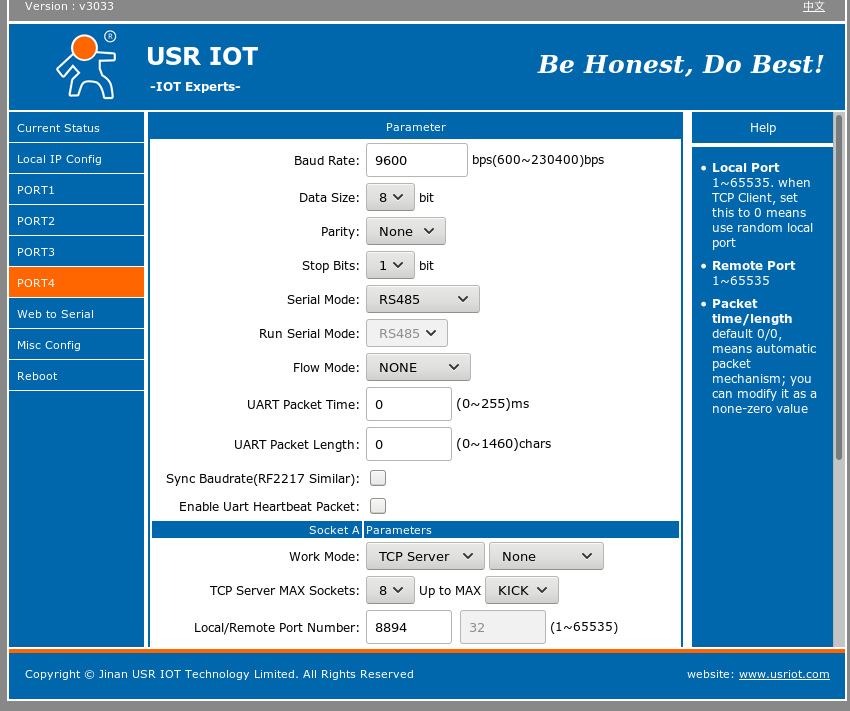

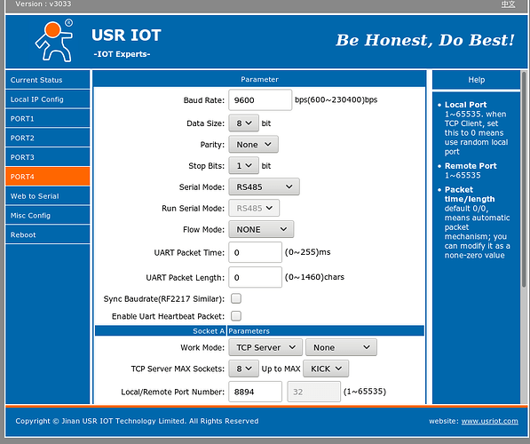

Hello. I have some issues with connecting to my device (IntesisBox ME-AC-MBS-1) by tcp using USR IoT USR-N540 (device use rs485 so i should use serial to IP converter). After configured my USR-N540, i must be able to connect with device by tcp using Openhab. But communication with the device does not occur. I also try to connect using some python libs (pyModbusTCP) and with modbus-cli too, but my connection refused by device or something else that interfere me. I use CentOs-7 (if it matter). Ping ip of converter works fine. Please, help! Tell me if i need give more info. Thanks!

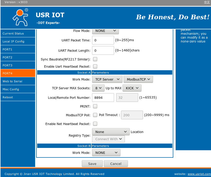

How you did that is pretty important. I think you’d want to set up the serial port with baud etc., and set “work mode” for Modbus server.
Okay, for a start if you want to use it for Modbus you need to change “work mode”.

Modbus-TCP is usually used with port 502.
I would advise against using any independent poll features, let openHAB manage polling.
That is true - but as the USR has 4 Modbus-ports you have to configure 4 different HTTP-ports.
As far as the Binding uses the configured ports there should be no problem.

Here is a working configuration from an other device: https://community-openhab-org.s3.dualstack.eu-central-1.amazonaws.com/original/3X/4/a/4a90427af5dac9d004d38d4d686b4b4e0bfb1698.png
SerialMode is set to DialSwitch, not to RS485 maybe that is the problem.
Thanks, i will try that.
