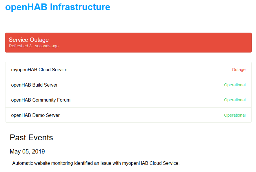

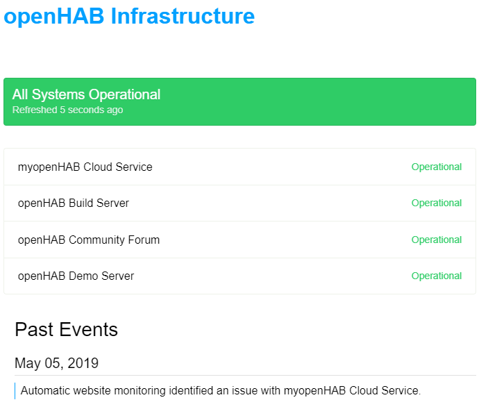

Where is this status from?
On openHAB Infrastructure Status is everything green.
4 minutes before your post the cloud status was red :grinning:
If you constantly refresh the status page you will see that it toggles from green to red and vica versa.
Ahh… I see… That’s great :man_facepalming:
Even if I refresh the status page it always shows ‘Operational’ hence why I have spent the last couple of hours doubting my code changes or hardware etc.. Oh well best sleep on it.

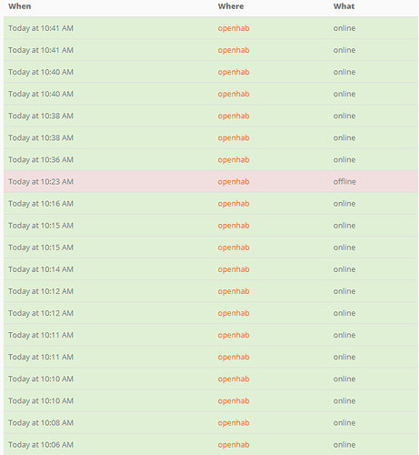

It seems stable now.
My reoccuring errors have gone for some minutes now.
