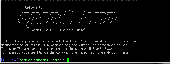

Yes from the command line, see below. The default password for this should be openhabian.
Hi - I looked it up and if I am correct this is used for Raspberry Pi SSH.
I’m using synology NAS. Is it possible to use openHABion on synology installations? thx
Never used OH with synology but if sudo openhabian-config doesn’t open the tool then I guess not.:thinking:
