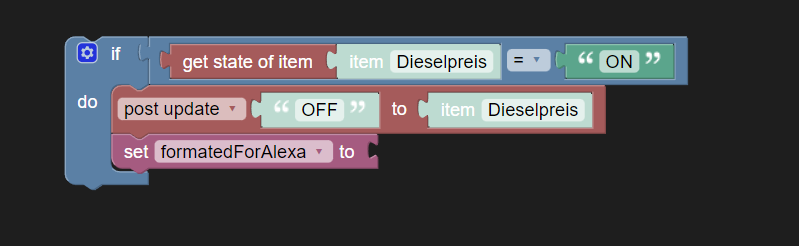

Well I created the rule up to the point where I need to construct the string.
I created a variable but other than that I am not sure how to continue now.
Can you show us?
Currently it is only this, because I do not know how to continue in blockly:

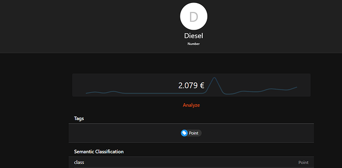

Great! And can you give an example value for your Item TankstelleOIL_Diesel?
It like this:

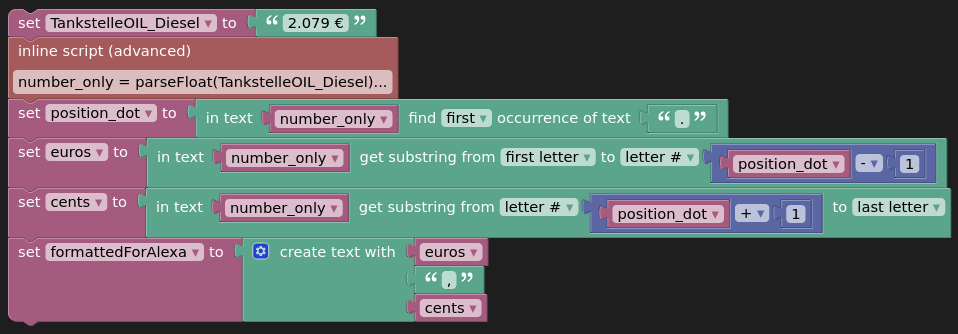

Well this is not fun! To convert
val String formattedForAlexa = (String::format("%.2f", (TankstelleOIL_Diesel.state as DecimalType).floatValue())).replace(".",",")
into Blockly I’ve come up with this ugly thing:
The first bit forces the string into a number, and then rounds to the nearest two decimal places. Blockly has no native function for that. The code in that block is:
number_only = parseFloat(TankstelleOIL_Diesel).toFixed(2)
There’s no native string replace function in Blockly, so I’ve had to hack my way round by finding the position of the dot, splitting there, and then re-combining with a comma in-between. You could do this all on one line in Blockly, but that makes taking a screenshot difficult…!
The whole generated code looks like:
var TankstelleOIL_Diesel, position_dot, euros, number_only, cents, formattedForAlexa;
TankstelleOIL_Diesel = '2.079 €';
position_dot = number_only.indexOf('.') + 1;
euros = number_only.slice(0, position_dot - 1);
cents = number_only.slice(((position_dot + 1) - 1), number_only.length);
formattedForAlexa = [euros,',',cents].join('');
To be honest, there are much quicker ways of achieving this using pure Javascript inside the inline script (advanced) block. If it were me, I’d go down that route…

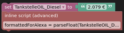

Could you elaborate on that? Would love to hear more about this aswell
Sure. You can reduce all of that Blockly code into the following:
Where the inline script has the following:
formattedForAlexa = parseFloat(TankstelleOIL_Diesel).toFixed(2).replace(".",",")
The limitations in Blockly would, I think, end up with me just using a plain Javascript rule/script here instead of Blockly, because replacing (and later for you, splitting) text is a little painful (and the inline script (advanced) block is difficult to work with for anything more than a short line, at least for me on Firefox).
