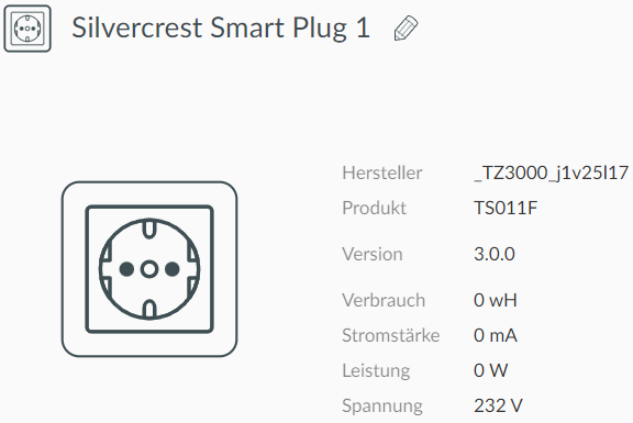

Well, I would like to use the consumption, current and power channels, too. As these are shown in the deCONZ app:
Is there a way to get these values? I also tried to manually add a powersensor and consumptionsensor in openHAB, but this did not help.
