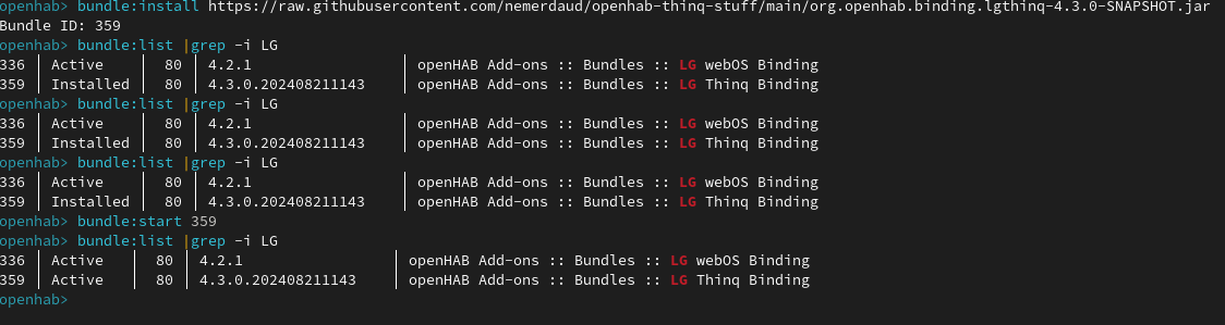

Try #2 → bundle:install
bundle:install https://github.com/nemerdaud/openhab-thinq-stuff/blob/main/org.openhab.binding.lgthinq-4.3.0-SNAPSHOT.jar
returns
Unable to install bundle https://github.com/nemerdaud/openhab-thinq-stuff/blob/main/org.openhab.binding.lgthinq-4.3.0-SNAPSHOT.jar: org.osgi.framework.BundleException: Error occurred installing a bundle.
The correct URL to direct download is: https://raw.githubusercontent.com/nemerdaud/openhab-thinq-stuff/main/org.openhab.binding.lgthinq-4.3.0-SNAPSHOT.jar
Try it out and see if something changes.

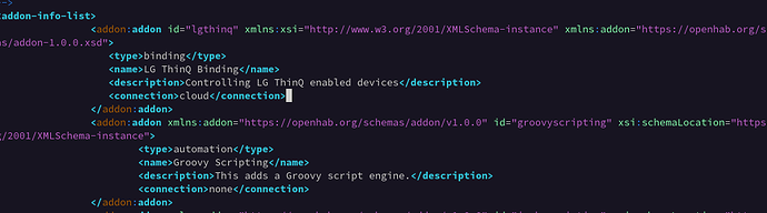

I took a look with more detail in this case and could found that for me, after 4.2.1 upgrade, the binding doesn’t appear in the UI anymore, but is still working, i.e., if you’ve already have a thing configured with this binding, it will work properly, you can see it and the channels, etc. But if you try to add a new LG Thinq Thing, it won’t be available to add manually (only by discovery).
It’s a very strange behavior because there’s no change in the binding’s descriptor between the version that justify this issue.
So I did a diff between 4.2.0 and 4.2.1 files to find whats changed and I found a file named addons.xml that was created in the 4.2.1 version. I don’t know how this file is managed and updated or if it’s a static file, but this file holds the descriptor of all the distribution’s addons that doesn’t include mine, because it’s still in review.

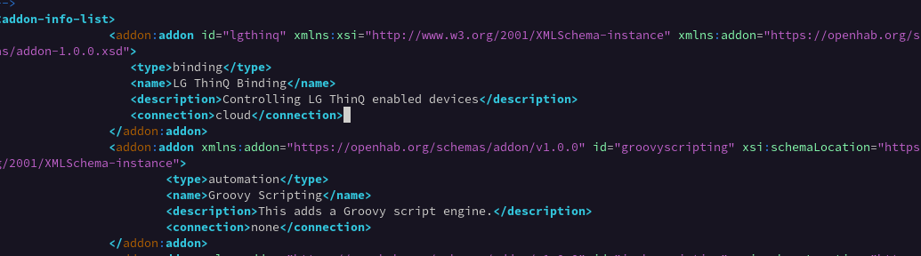

Well, all this to say if you add this (<addon:addon id=“lgthinq” … </addon:addon>) at the beginning of the openhab-sys/runtime/etc/addons.xml file:
        <addons>
                <addon:addon id="lgthinq" xmlns:xsi="http://www.w3.org/2001/XMLSchema-instance" xmlns:addon="https://openhab.org/schemas/addon/v1.0.0" xsi:schemaLocation="https://openhab.org/schemas/addon/v1.0.0  https://openhab.org/schemas/addon-1.0.0.xsd">
                   <type>binding</type>
                   <name>LG ThinQ Binding</name>
                   <description>Controlling LG ThinQ enabled devices</description>
                   <connection>cloud</connection>
                </addon:addon>
Restart the OH and it should work. Let me know about the result. If you confirm that it start to work, I will open another topic because it’s probably a bug in the core.

Using the correct URL I now also was able to install the JAR and get it active, but I too, now cannot add a new Thing.
Just for the record, the OH version is 4.2.1. The “-1” suffix originates from the linux package enumeration and should never ever be used anywhere (like in addons.xml)
I suggest you to ask for help/comprehensive explanation on this.

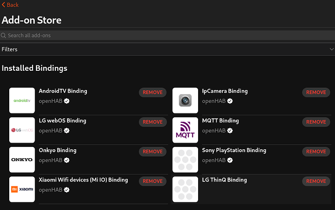

OK, lets check it again step by step. I think this is important to be a guide to people that have +4.2.X until I known an official explanation about this behavior change beginning at 4.2:
  1. Check the current configuration
    • Access the console and check if the lgthinq binding is currently instaled and activated by karaf:
    • Confirm that the binding is not recognized by the OH UI in AddOns Store and not available to be manually added in the Settings->Things

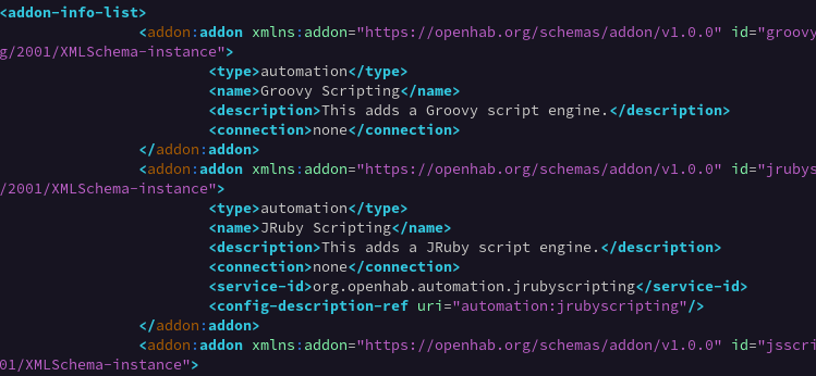

  1. Verify the addons.xml file: /srv/openhab-sys/runtime/etc/addons.xml. It should start like this:
  2. Change that file in order to add the following entry:
                </addon:addon>
To result in something like this:
5) Restart the OpenHab

  1. Check the OH UI again to see if the binding is now available at AddOns Store as installed and to be manually added in the Settings->Thing.
Those are the procedures I did to get the binding available in the UI. Let me know if it works for you !

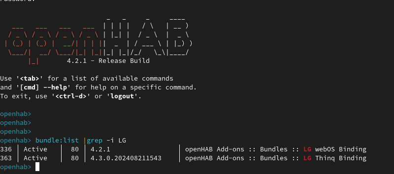

329 │ Active │  80 │ 4.3.0.202408211143    │ openHAB Add-ons :: Bundles :: LG Thinq Binding

  2. Verify the addons.xml file (/usr/share/openhab/runtime/etc/addons.xml) → can confirm the first node was “Groovy Scription”
  3. Change that file in order to add the following entry → OK / done, the first node is lgthinq now (+ verification if addons.xml is openhab:openhab)
  4. Restart the OpenHab → OK / done (at this point no entries in log)

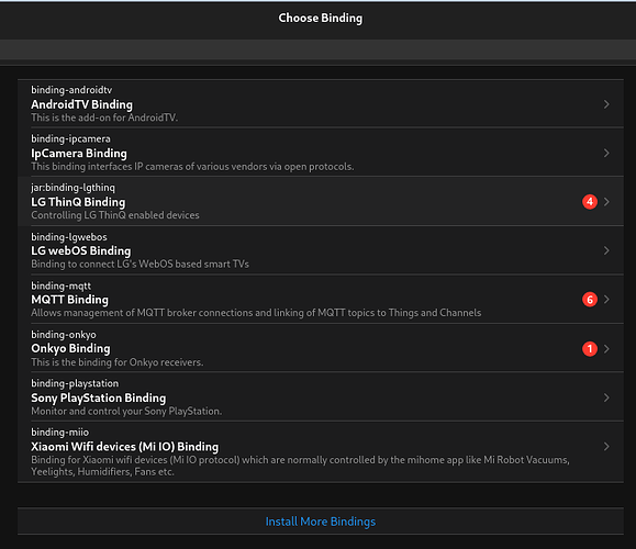

  5. After completed restarted, touch the binding file → binding is not shown in addon-store, putting the .jar under /usr/share/openhab/addons and touch(ing) it → .jar has now a current timestamp (at this point no entries in log)
  6. Check the OH UI again to see if the binding is now available at AddOns Store → unfortunately not available

  11. bundle:install
bundle:install https://raw.githubusercontent.com/nemerdaud/openhab-thinq-stuff/main/org.openhab.binding.lgthinq-4.3.0-SNAPSHOT.jar
  1. bundle:start after verifying new bundle ID(!)
bundle:start 326
  1. repeat step8) and step9) → empty
  2. repeat step7) → unfortunately not available
Stopping my tests now, have a great day!

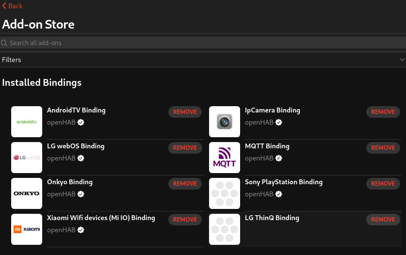

FWIW, I tried the above steps as well and have had similar results.
Hi, I tried all the steps listed above.
Installed the addon, copied and touched the file in addons folder.
But the binding does not show up in addon browser and can not be selected in thing creation dialog.
Can i provide anymore information for you ?
I really don’t know why, but it’s not that smooth to install jar binding after 4.2.0 anymore. A number of users are reporting problems, even in my 4.2.1 installation it’s working normal.
To avoid this, since the binding is almost finished for the first stable release and it’s been reviewed to be officially available in regular OH distribution, I published it in the Community Marketplace to be easy to integrate with new OH versions.

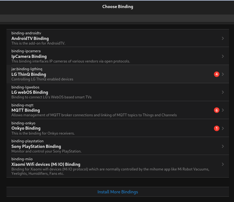

Please, try to install new binding from the main OH UI (Add On Store > Binding > Community Marketplace) and try to find “LG Thinq Binding”. It’s point to the latest supported version for the OH stable version
Let me know if it’s working for you.
Integration via the marketplace works. :grinning:
I was able to create a bridge and Things via the UI.
The first installation failed, but after cleaning up the addons folder and “build:uninstall ” the installation went through.
Thank you for this LG integration and very quick response.
