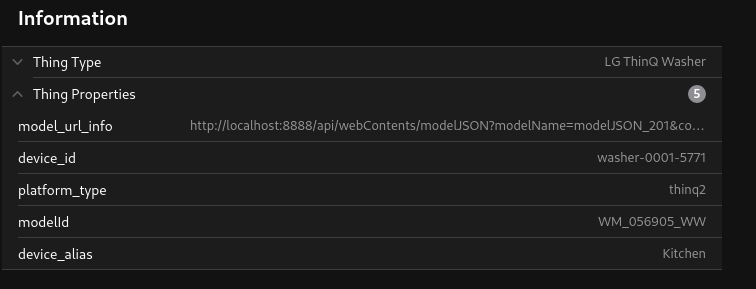

I’m looking for someone that has Thinq V1 Washer. But, from the model I can’t know if it’s V1 or V2. You have to install my binding, registry your device and in the configuration of the Thing, you can see the properties information. Something like this:
If your platform_type is thinq1, then you can help me with some tests.

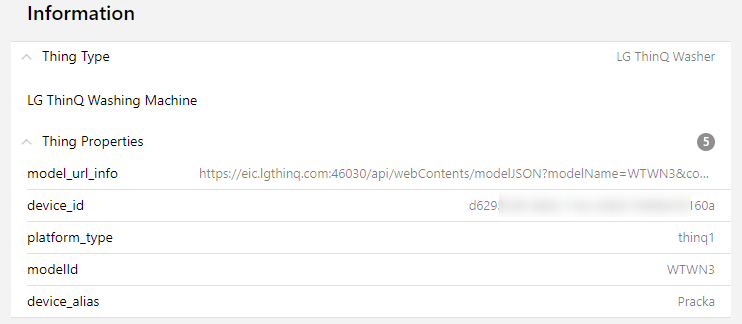

Hi Nemer,
I have Washer V1 working with your binding (very old version: 3.3.0.202206021838).
