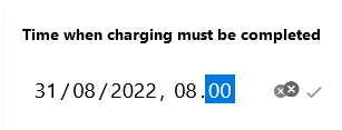

  1. Create an Item and input slider where you can select how many hours you want to charge the car
  2. Create another Item and datetime widget where you can define when the car needs to be charged
  3. Create a rule, which says that “after the datetime Item has been updated, find the X cheapest hours between now and the time when the car needs to be ready”, where X is the number you defined with the slider. You can either use the waterheater.js for this, if you want that the charging must not get interrupted, or nibe.js, if it is OK that the charging gets interrupted in between.

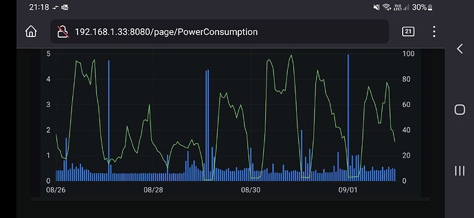

I guess your right as allways, I will keep fine tuning parameters until it gets really good. Power consumption really goes the right way below is s photo of my hourly consumption from 1st of september and as soon as price drops my consumptions peaks. Average idling consumption with two home offices running is 2kw per hour and nightly peak of more than 10kw an hour.
August average spot price was 32.4 c/kWh in Finland (incl. tax). If we would have a spot price contract, we would have paid 22.5 c/kWh. In other words, we were 9.9 c/kWh below the average.
Our contract is 14.8 +/- delta, where delta was in August this -9.9. So we pay 14.8-9.9 = 4.9 c/kWh. This translates to 67% discount. :slight_smile:
Here’s the last 7 days consumption vs. spot price graph
Well it seems like my timestamps run into some trouble because when rules isn’t run in even hours the time offset for measurments in database can be up 18:20 instead of 18:00 and then the control script doesn’t find any measurment and defaults to 1, so theres still some work to be done with my date time items triggering the funkctions
1 Set hours for ev charger N hours from dateitem1.state and until dateitem2.state this seems to get offsets in influx db so that next script that checks if control = 0 or = 1 and toggle switchitem in OH. I will keep troubleshooting this first of all run the rule every hour but only if ev is connected and the maybe be able to use that time for start time.

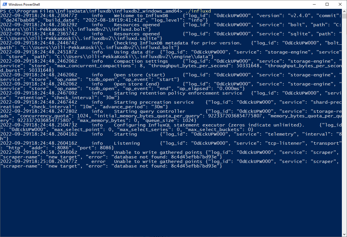

I think everything is now up and running, but for some reason the data is not saved to InfluxDB. OpenHab is giving the following log info:
When I increase the log level, I can see an InfluxDB related error which says “X-Platform-Error-Code: not found”. InfluxDB is run via Powershell and there I can see errors “database not found” and “unable to write gathered points”.
How do I configure InfluxDB to receive the data correctly?
Are you able to log in to the Influxdb web user interface?
If yes, pay attention to the IP address, port and user credentials and update them to influx.js. after making the updates to influx.js, you need to re-save the openHab rule to make those changes take effect.
Markus
Yes, I can log in to the Influxdb and I have updated the user credentials to influx.js.
I run OpenHab via command prompt using command ssh -p 8101 openhab@localhost and InfluxDB via Powershell with command ./influxd in the influxd.exe folder.
OpenHab opens in address localhost:8080 and InfluxDB in localhost:8086. I have no idea what I’m doing but I feel I’m almost there :smiley:
Do I need to make a query in InfluxDB or should the spot prices appear there automatically after running the “FetchSpotPrices” script in OpenHAb? I can’t see any buckets or data there. I have created an AllAccess API and it is updated to the influx.js.
This is the powershell window view:
You need to create the Influxdb bucket first and have an operational InfluxDB, otherwise the script has no place where it would write the data. The Influx user also need to have write access to your bucket.
