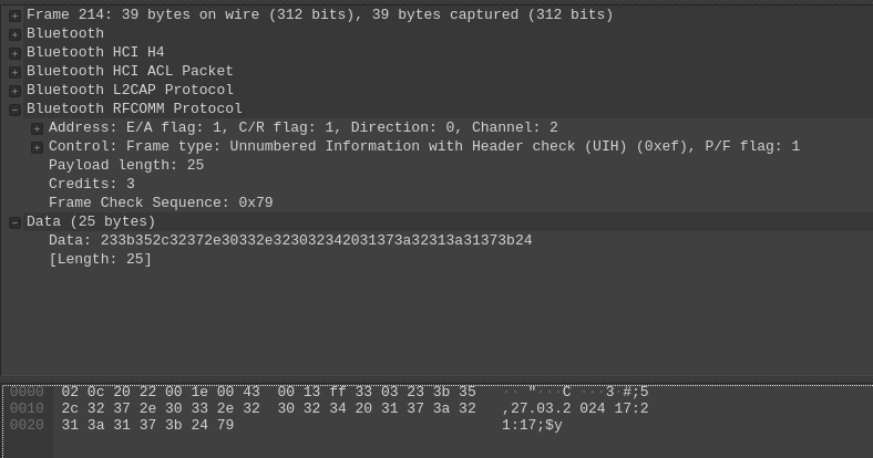

Yes, I have recorded the Bluetooth interface with my smartphone and have a Wireshark log.
Here I can see that the time is transferred in plain text.
Here is an excerpt:
0000   02 0c 20 22 00 1e 00 43 00 13 ff 33 03 23 3b 35   .. "...C...3.#;5
0010   2c 32 37 2e 30 33 2e 32 30 32 34 20 31 37 3a 32   ,27.03.2024 17:2
0020   31 3a 31 37 3b 24 79                              1:17;$y
