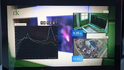

Xibo itself is working nicely with the grafana-charts and the video-output from the ipcamera binding.
