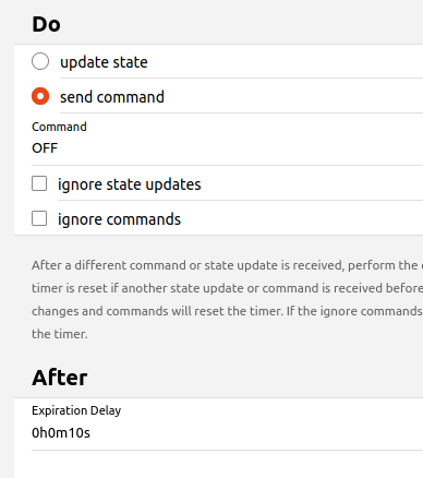

You could use the metadata expire on the switch item to turn off after 1 second?
Below is one I have for 10 seconds.
Thanks for the hint but unfortunately it does not change anything.
The state of the item in OH seems not to be the problem but Google doesn’t notice that change (quickly enough). So unless there is any pointer to give to Google that this should behave like a push button and not as a switch will likely not help?
