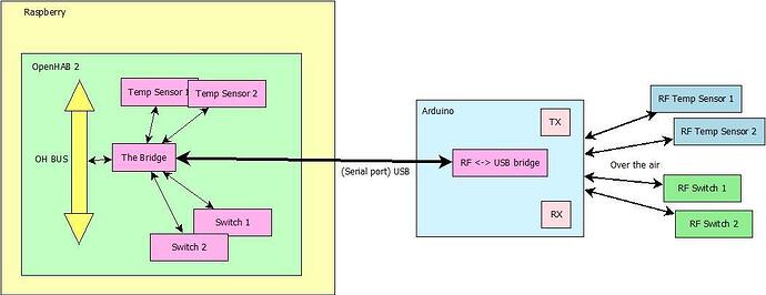

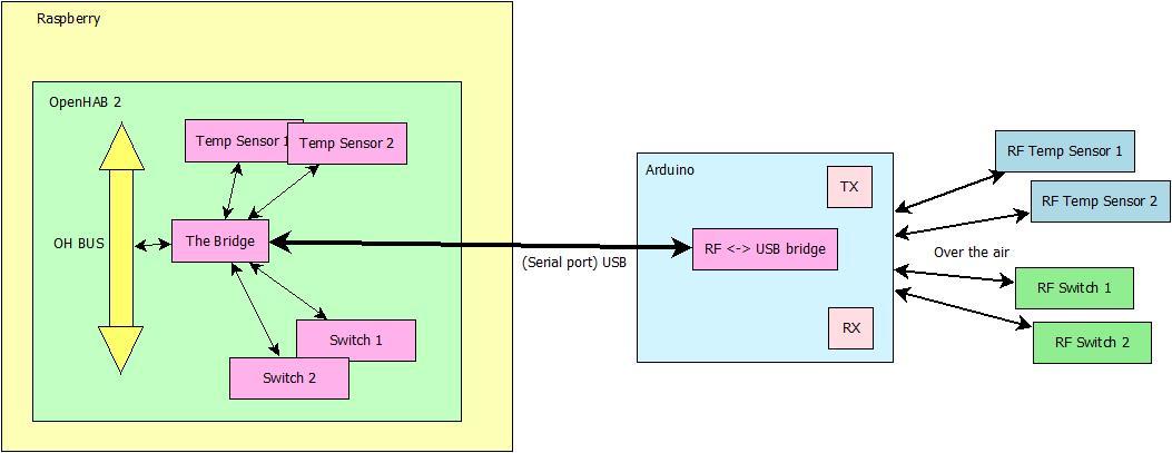

Hi all, hi Jokerit.
I’m working on a solution similar to what you described.
In particular, I’m implementing the following solution, based on OpenHAB 2:
  • I developed a new Binding, able to read events from the serial port and to send commands too.
  • The binding module acts as a bridge towards real sensors/actuators
  • sensors/actuators, via RF 433mhz, interacts with a cheap arduino nano, connected via serial port (USB) to the raspberry OpenHAB server.
In general, a cheap RF sensor sends data via 433mhz with a pack of data; for example, I bought a magnetic door sensor sending a 4 bytes data pack, where the first part of the pack is an ID (customizable acting on internal switches) and the second part of the pack is a static xFF value.
The pack is sent multiple times over the air for a single event.
You may say: “You could avoid to use Arduino to connect the RF circuit to Raspberry!”.
True, but I preferred this solution for 2 reasons:
  1. Separation of responsabilities
  2. By connecting Arduino to my development station, I can debug the TXRX circuit in a more efficient way.
In the developed binding, adding a new sensor consists of registering a new Item in OpenHAB, with its ID as attribute. Depending on the sensor type, I provided other attributes: temperature, door status, humidity, and so on…
Actually, I’m waiting to receive the RF modules from China, so I tested the whole architecture by wiring sensors on the Arduino side and sending ID+data to OpenHAB via USB. At the moment, this mock is working.
I see a lot of post readers discouraging the interaction with this type of sensors… I’ll appreciate all contribution and suggestions to that solution.
Of course, Z-wave and ZigBee sensors are more stable and secure in trasmissions, but they costs 10 times more than RF sensors… I’m playing, so I can’t pay 50 euros for each sensor…
Regards,
Alexxn

This is what I did…
