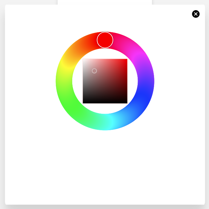

The issue comes when I attempt to test the color channel by inserting a colorpicker cell in my overview, add a colorwheel module for instance, and select the aforementioned Color item.
When I test this colorpicker in run mode, I see nothing but a blank space, which leads me to believe that the state topic or transformation is not working.

Good analysis. The colorpicker requires a valid starting Item state, NULL won’t do.
Confirm by checking Item state directly - API Explorer perhaps.
That’s just too many parts for RGB, so the colorMode cannot digest it. I think you’ll need a custom transformation for whatever that means; or at least pre-process the RGB part out, if there is one.

Try adding a new Channel to your generic thing to test as you can’t change channel types after they have been added.
  - id: HSB_COLOR
    channelTypeUID: mqtt:colorHSB
    label: Color of my bulb
    description: ""
      commandTopic: cmnd/my-bulb/HsbColor
      stateTopic: stat/my-bulb/RESULT
      transformationPattern: JSONPATH:$.Color
Link the channel to an item and the item to a color picker.
If you don’t see the wheel the item is probably NULL

This does work, due to the triple. I’ve added CT and Dimmer channels which will work for now, thanks.
