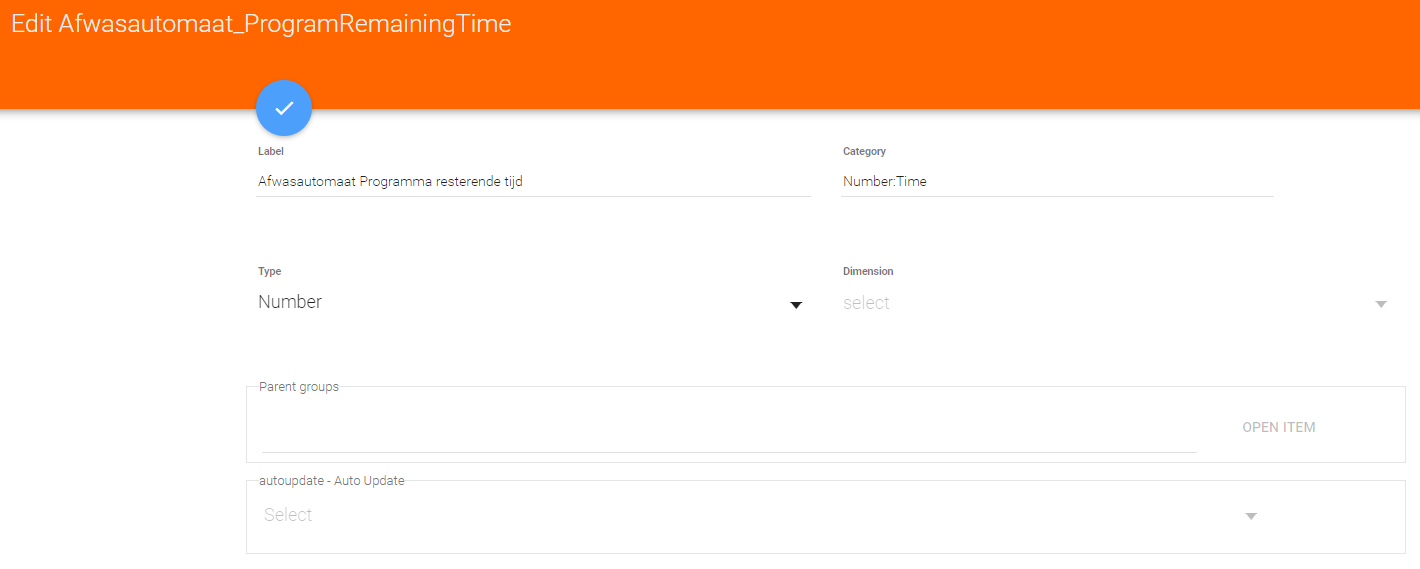

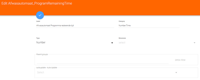

Please post the Item definitions for both Items, the rule you are currently using, and the error message. Also, paste this into a rule file, save, and post the logs
rule "Test"
	System started
	logWarn("Rules", "AA_ProgramRemainingTime.state: {}", AA_ProgramRemainingTime.state)
	logWarn("Rules", "Afwasautomaat_ProgramRemainingTime.state: {}", Afwasautomaat_ProgramRemainingTime.state)
The item from the miele cloud binding is in Paper UI and the item to the Siemens PLC is in a .items file.
Number  AA_DelayedStartTime         "PLC Afwasautomaat Vertraagde starttijd"        { simatic="plc1:DB803.DBW12:word" }
rule "Afwasautomaat Vertraagde Starttijd"
	Item Afwasautomaat_DelayedStartTime changed
	if (newState != NULL) {
	AA_DelayedStartTime.sendCommand(newState)

After I loaded the test rule I started a delayed start program on my dishwasher. A couple of minutes later I aborted the program and switched the machine off.
No test rule?
Use this instead
	    AA_DelayedStartTime.sendCommand(newState.toString)
