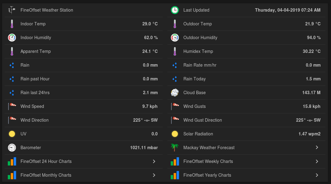

Snapshot:
Hoping this is helpful to others …

@Udo_Hartmann and @zobelhelas you’re indeed right, I do like the look of this solution best though. Thanks guys.
EDIT: it doesn’t work as expected though.
