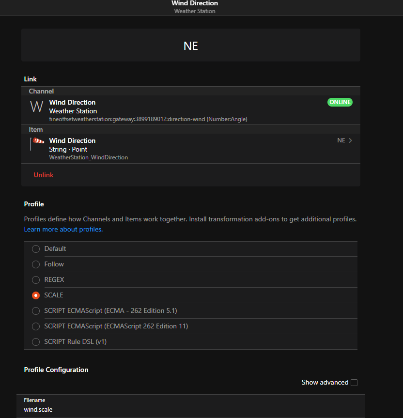

Finally got this working.

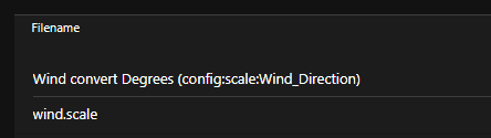

If I use a Profile transformation then it works. The Item is a string but the channel is a number:dimension.
I created a scale file but could have selected the transformation I created in the GUI.

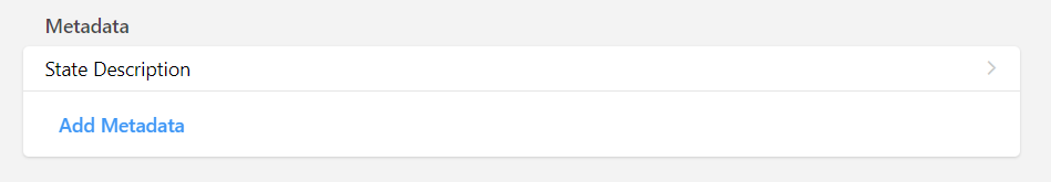

so in step 4 where did you put the State Metadata if not in Pattern?

I added metadata to the item, and chose State Description.

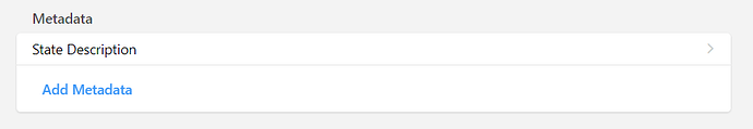

It seems like that field didn’t get saved when the item was created.
EDIT: it seems like that “State Description Pattern” field shows up for number items with dimensions, but changing it when creating the item doesn’t appear to do anything. I would expect it to generate the required metadata.

You’re using a profile to transform the channel data before sending it to the item. That’s why you have to have a string item to receive the string value. The log will show the transformed string value, because that’s what’s stored in the item.
Rich and I are using item metadata to transform the data after it has been sent to the item. This preserves the original data, so it doesn’t need to be a string item. As a result, the log shows the original data, and the transformed value is displayed in openHAB UIs. It’s purely cosmetic.
