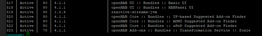

Failed transforming the state '49 °' on item 'WeatherStation_WindDirection' with pattern 'Scale(config:scale:Wind_direction):%s': Couldn't transform value because transformation service of type 'Scale' is not available.
bundle:list shows it loaded
The examples on the add-on readme show all uppercase. SCALE instead of Scale.
changing to SCALE eliminates the error in the log.
