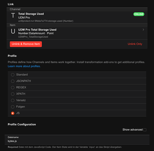

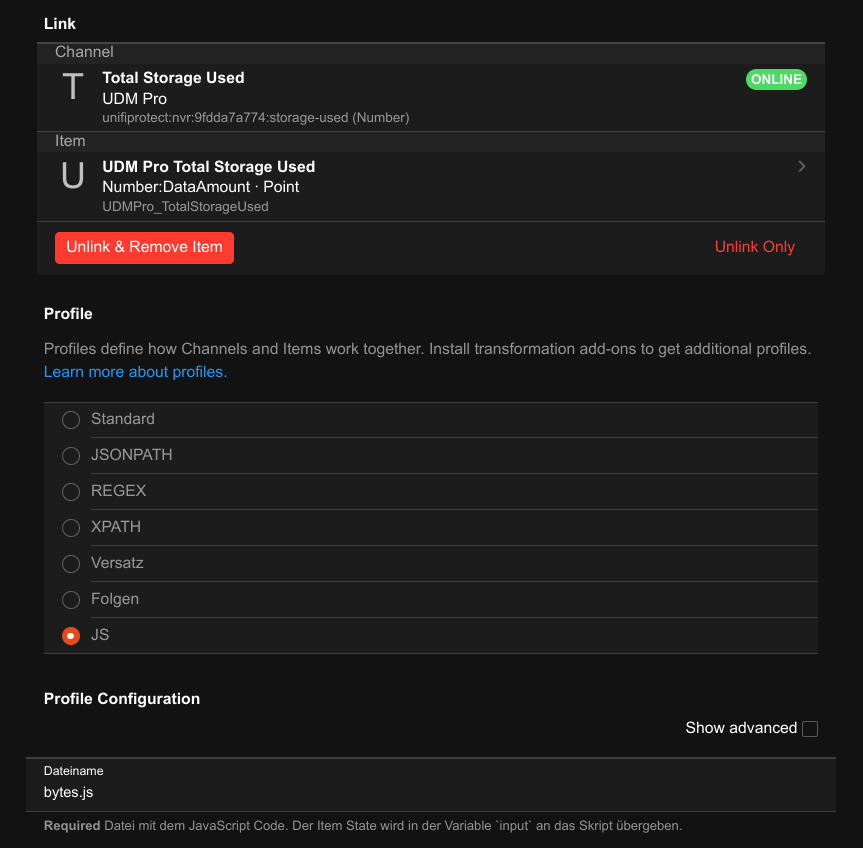

OK, got it working. I installed the JS transformation. Then I wrote a small JS named “bytes.js” in the transform folder like this:
(function(i) {
    return i + "B";
})(input)
And then used that in the channel transformation profile setting:
Then I set the pattern “%.1f GB” in the model State Description. Now I have everywhere “X.Y GB”, like I wanted. Still think this is too complicated.

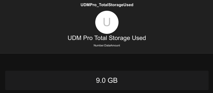

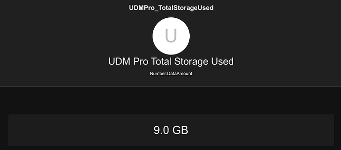

One strange thing with my current solution remains:
I have set pattern “%.1f GB” and when I click on the item, I see this:
But in the list of items, I see this:
Why is it not using only one decimal in the 2nd case?
