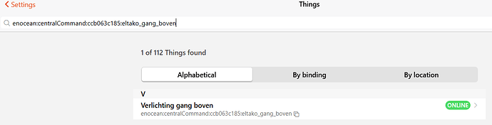

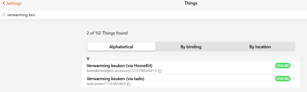

By accident, I noticed that if you enter a search filter in the Things overview, like this:
… the small Copy UID “double square” might copy the wrong UID. For instance, I tried copying homekit:bridged-accessory:72157980e9e1:5, but turned out with enocean:centralCommand:ccb063c185:eltako_gang_boven on the clipboard.

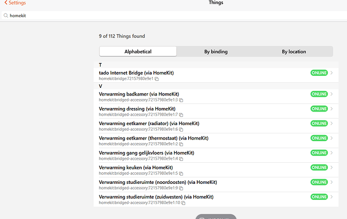

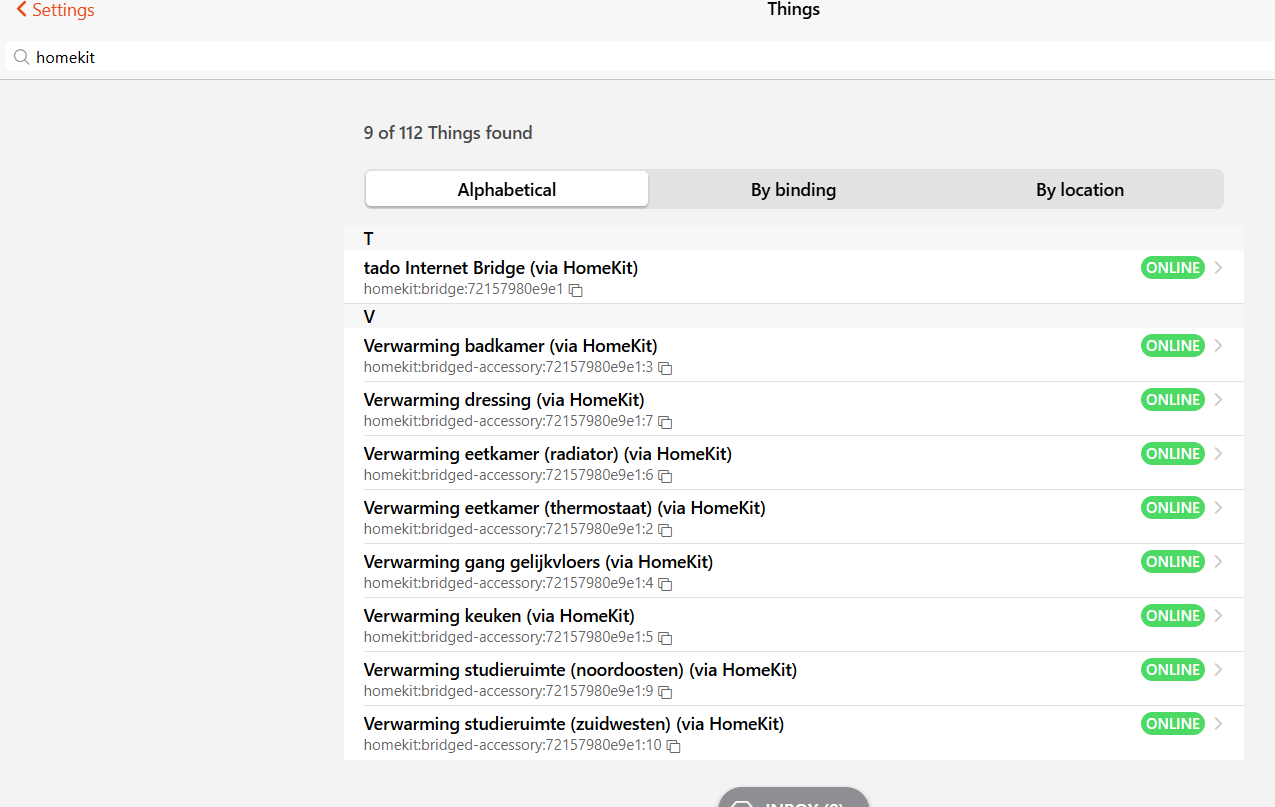

Trying to copy homekit:bridged-accessory:72157980e9e1:5 from this setup:

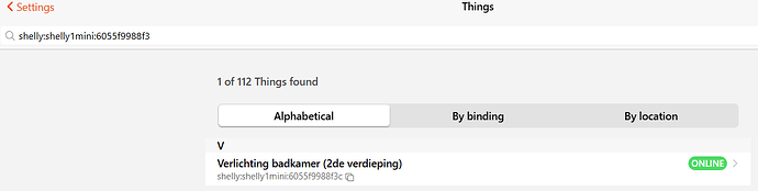

… gives me shelly:shelly1mini:6055f9988f3.

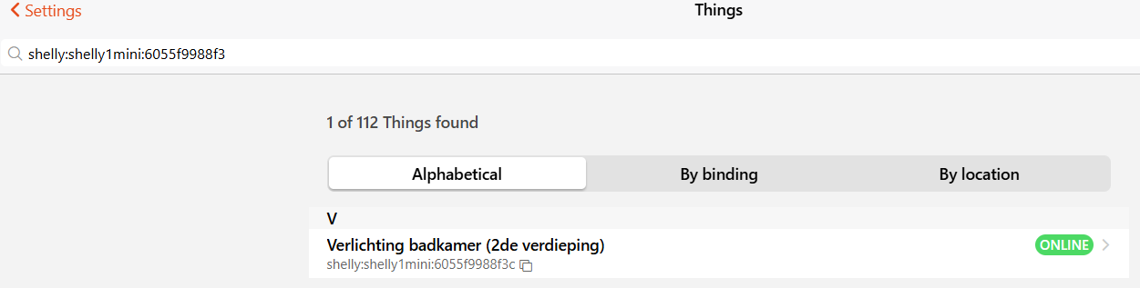

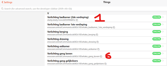

I thought that maybe shelly:shelly1mini:6055f9988f3 would be the first Thing listed (and the filter wrongly renders the first overall Thing, instead of the first Thing in the selection), but that’s not the case:
(Obviously, I have Things named with letters prior to V ;))

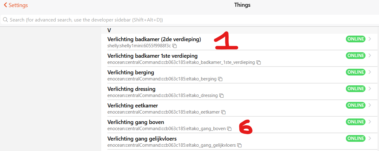

But look: enocean:centralCommand:ccb063c185:eltako_gang_boven:
So I think I was half right:
So it takes the first overall Thing which has a label that starts with the same letter as the Thing that’s shown in the filtered view.

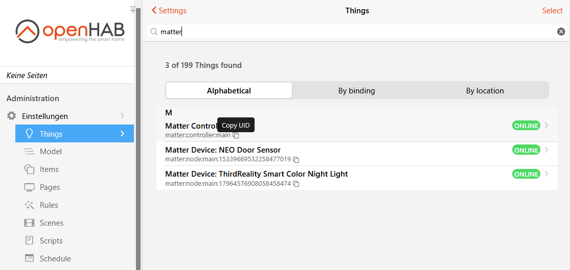

I had a similar (same?) experience on 5.0.0.M2:
I don’t see this issue anymore, I think it vanished with openHAB 5.1.0.M3.
Aha. No need to file an issue then. :slight_smile:
