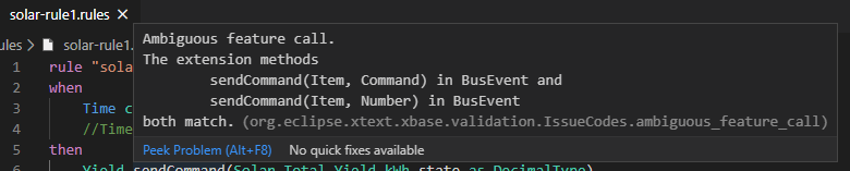

Every night at 23u59 I’m writing the value of an item to another item. It’s just a summary of the total yield of my solar panels. I use the value to subtract it from the totals of the day after. To achieve this I’m using this rule:
rule "solar-rule1"
    Time cron "00 59 23 1/1 * ? *"
    Yield.sendCommand(Solar_Total_Yield_kWh.state as DecimalType)
It has been working great for the last couple of months but there was always this error in Visual Studio Code that I don’t understand.
If I try to use this as rule, the Visual Studio code error goes away but then I get an error in the console.
Yield.sendCommand(Solar_Total_Yield_kWh.state as Number)
[ERROR] [ntime.internal.engine.RuleEngineImpl] - Rule 'solar-rule2': Could not cast NULL to org.eclipse.smarthome.core.library.types.DecimalType; line 5, column 79, length 26
