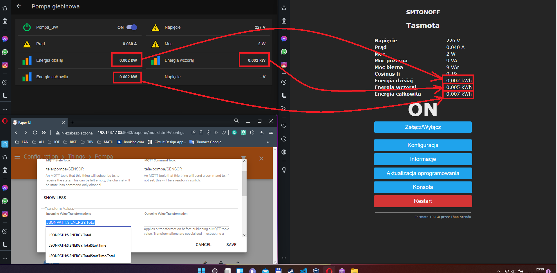

What should be the correct formatting for: Incoming Value Transformations
JSONPATH: $. ENERGY.Today
JSONPATH: $. ENERGY.Yesterday
JSONPATH: $. ENERGY.Total
I have differences between what is read in the main window of TASMOTA or consol … and what is seen by OPENHAB.
yep I know that. TelePeriod command is set to 300 by default.
Updates - I handle it a different way. I set PowerDelta to 1 ( 1..100 = set reporting on percentage power change to send an MQTT telemetry message)
Okay, I don’t know what’s going on.
I have removed these 3 defective ITEMs. I restarted OPENHAB and reconfigured them in the same way as before. They work.
I don’t know what was wrong. I was convinced there was something wrong with the transformation for them.
