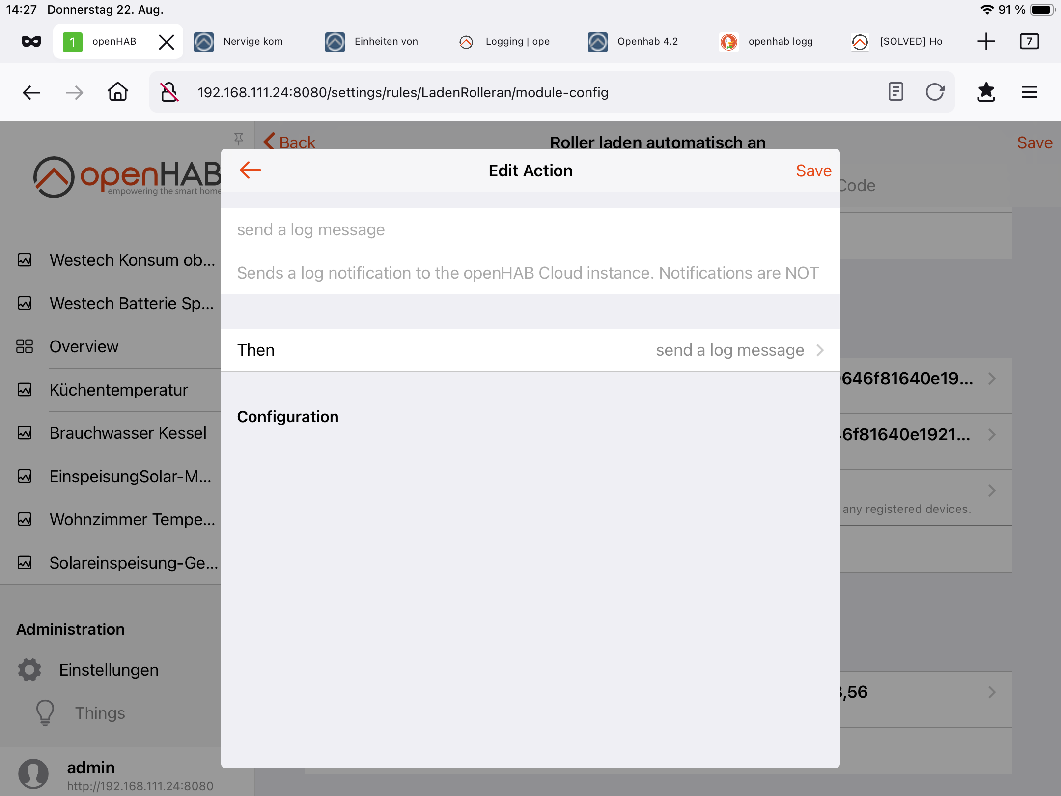

Dear all, can anybody send an example who to fill in

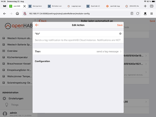

I try several “Xx” as in the pic without “” … and soon. But can’t find out
So how is the correct syntax.

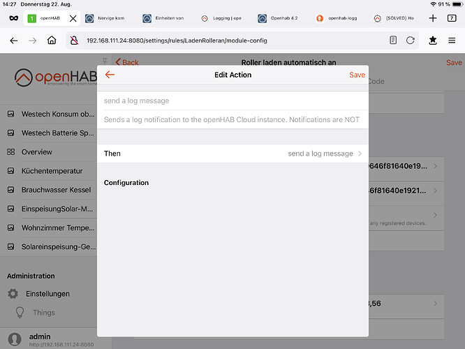

What ever i type in: for example:
I always get the error:
HANDLER_INITIALIZING_ERROR
BlockquoteGetting handler ‘notification.SendLogNotification’ for module ‘5’ failed: Param ‘message’ should be of type String.

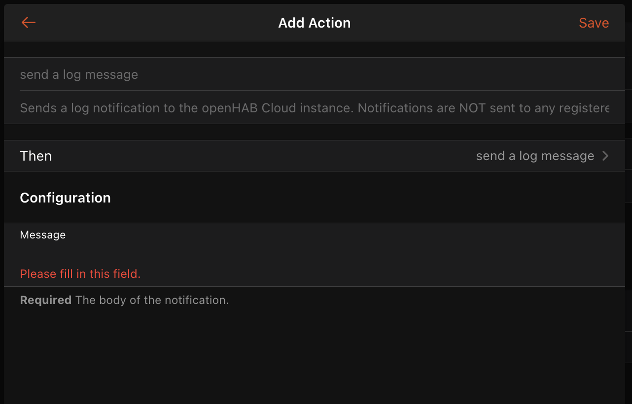

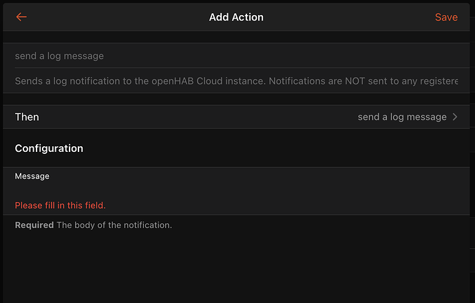

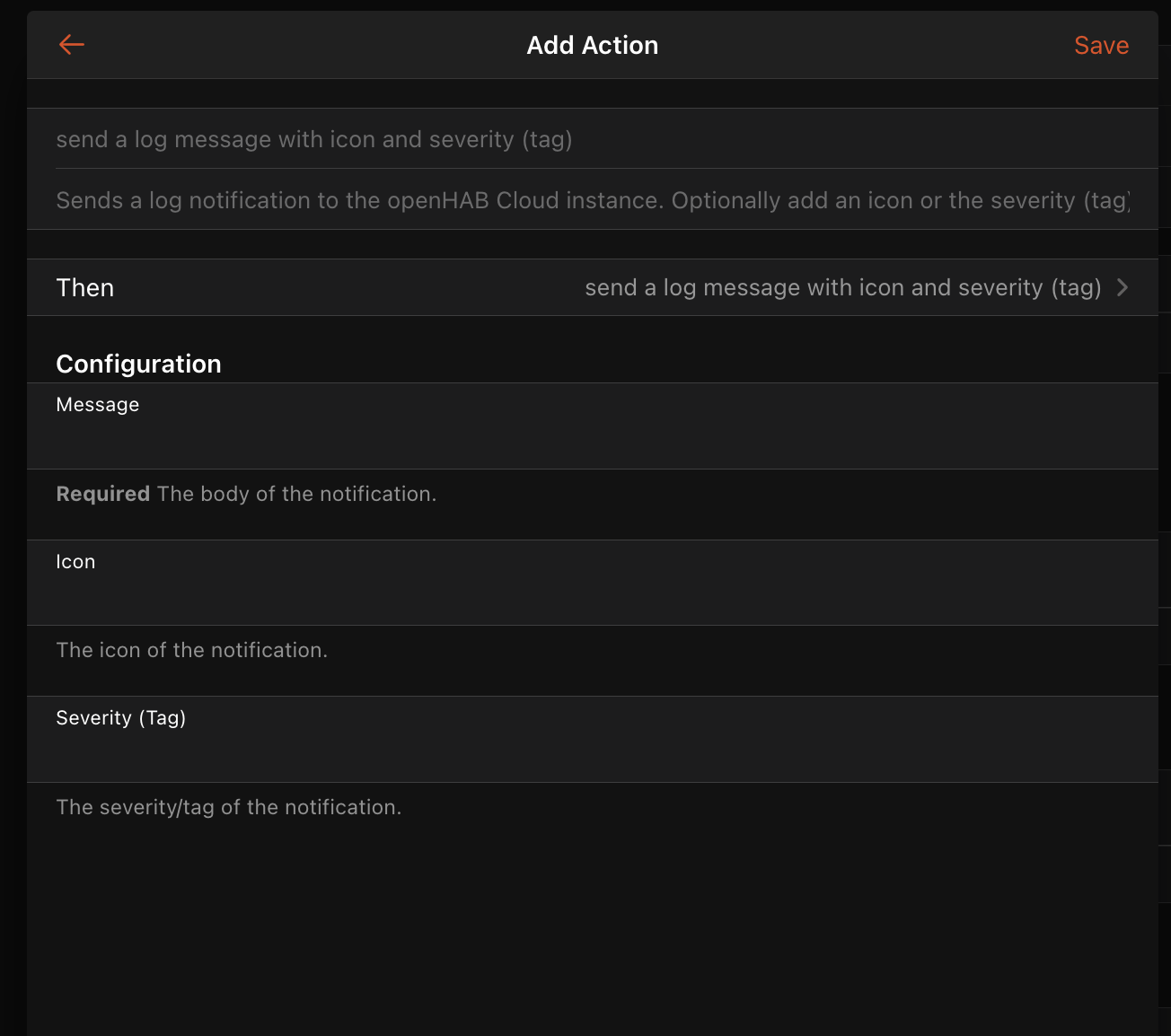

It is actually supported if you chose the one with tag / severity
Weird that the other one doesn’t even ask for the message.
This is indeed a bug. Fix:
