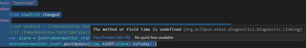

again I tried to do the same in RulesDSL, but I’m still curious about the correct syntax. even VSC states that the field time is undefined:
can someone pls doublecheck on your environment if toToday is working there?

Rules DSL is completely different. There is no time entity in Rules DSL. You can get now and then manipulate that. There is no toToday() in Rules DSL either. That only exists in JS Scripting with the helper library enabled (which is the default).
For Rules DSL, see ZonedDateTime (Java SE 17 & JDK 17). You’ll probably have to do something like the following in Rules DSL.
var toToday = new ZonedDateTime.of(now.toLocalDate, (entrydoormonitor_start.state as DateTimeType).zonedDateTime.toLocaTime, now.zoneId)
Each rule language is completely different. You can’t use a concept from one in the others. Always look at the docs in the language you are using for how to do anything.

even with the documentation I’m lost:
var toToday = new ZonedDateTime.of(now.toLocalDate, (entrydoormonitor_start.state as DateTimeType).ZonedDateTime.toLocalTime, now.ZoneId)
2024-01-02 23:21:06.388 [ERROR] [internal.handler.ScriptActionHandler] - Script execution of rule with UID 'testrule2-1' failed: An error occurred during the script execution: Cannot invoke "org.eclipse.xtext.common.types.JvmType.eIsProxy()" because "type" is null in testrule2
There’s a typo.
var toToday = ZonedDateTime.of(now.toLocalDate, (entrydoormonitor_start.state as DateTimeType).ZonedDateTime.toLocalTime, now.ZoneId)

2024-01-02 23:40:45.309 [ERROR] [internal.handler.ScriptActionHandler] - Script execution of rule with UID 'testrule2-1' failed: 'ZonedDateTime' is not a member of 'org.openhab.core.library.types.DateTimeType'; line 9, column 53, length 60 in testrule2
Try this:
val today_start = (entrydoormonitor_start.state as DateTimeType).zonedDateTime.with(LocalDate.now)
entrydoormonitor_start.postUpdate(today_start.toString)

Another typo. Lower case “z”.
var toToday = new ZonedDateTime.of(now.toLocalDate, (entrydoormonitor_start.state as DateTimeType).zonedDateTime.toLocalTime, now.ZoneId)
