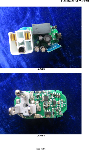

Looks like they are built on a ESP8266 - you could crack open and load Tasmota or ESPEasy.
Maybe someone has researched litesun products and knows more.
So I opened the unit. As it is an end user product, it does not have any obvious place to flash the EPROM. Is there a tutorial somewhere as to how to load new software?

Since there’s an ESP8266 inside you should just need a FTDI and then jumper to the connection points on the plug. You can use the ESPEasy loader to install the TASMOTA software…it’s fairy simple. It looks intimidating but it’s easy once you’ve done it.

FTDI is a USB to serial interface that you use to connect your computer to the device.
You will then install the ESPEasy loader to your Desktop PC to push and install the TASMOTA firmware via the FTDI to your device.
Here’s a great video to walk you through the steps: (this video is designed for SONOFF Brand devices…but substitute your device for the SONOFF)
