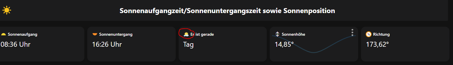

Is it possible to display a separate icon in a widget with YAML depending on the four possibilities (seasons, see circle)?
Season
And here my current YAML-Code:
component: oh-label-cell
  header: Es ist gerade
  icon: sun_clouds # to be changed depends on the value of the variable L
  item: Tag
Thank you very much! I wish you merry chrismas!
