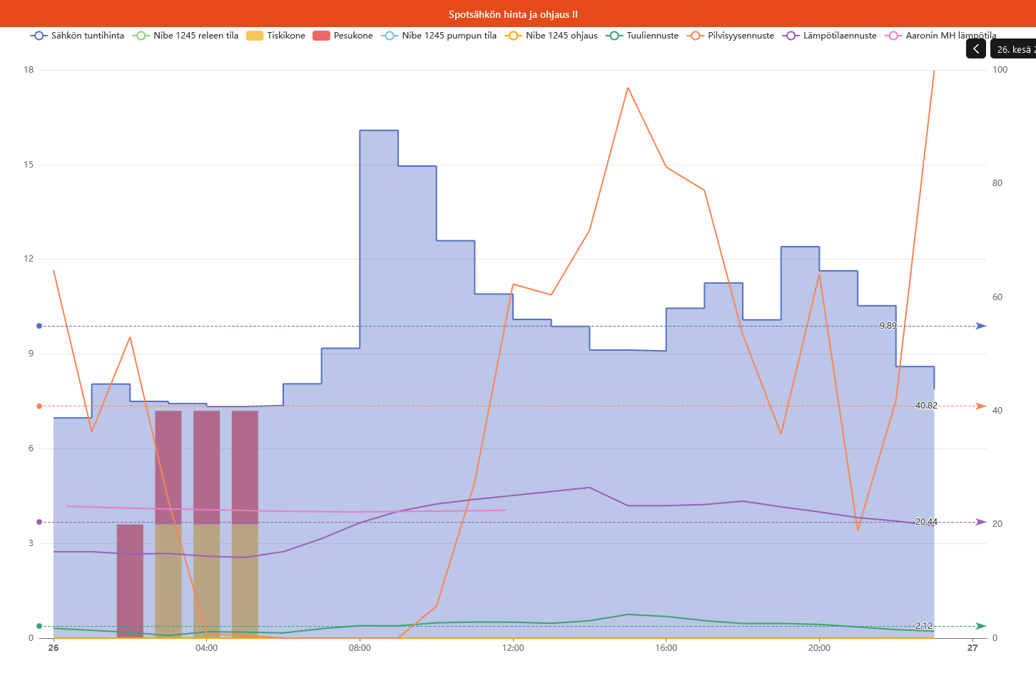

Just found out that the errors appear when I refresh my graph:

The graph works right, though.

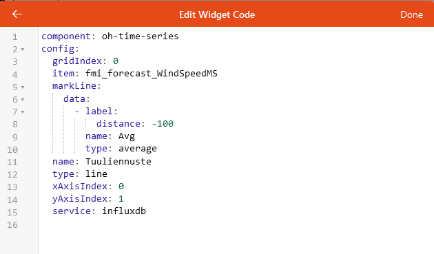

This is interesting… Did you enter the name of the control point to the chart YAML manually? I can’t think of any other way how the chart could be aware of that time series, if you had not created the Item with the same name earlier.
Markus
Yes. For example, the weather forecast from fmi has several forecasts named differently. I just added them to the scripts that fetch the data and then added the same names in the graph yaml. As far as I recall I never had any items created.

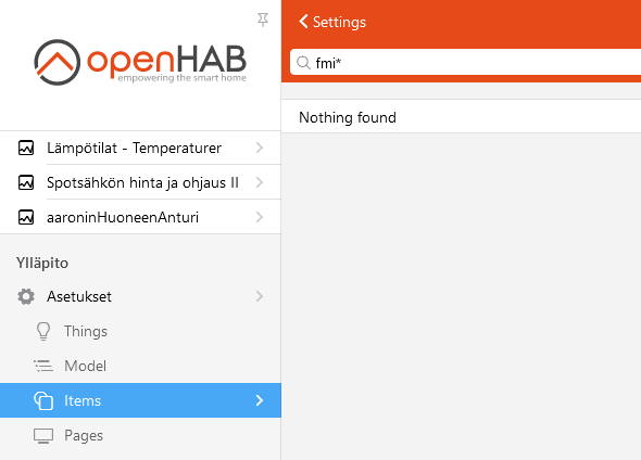

I still don’t get it how this is possible:
I have no items for “Tuuliennuste” or “Pilvisyysennuste”, i.e fmi_*:
They are, however, referred to in the YAML:
OpenHAB complains about these missing items, but still draws the chart.
My theory would be as follows. The interface between OH and InfluxDB is pretty generic. If you give it an Item name, even one that doesn’t exist in OH, it will happily generate a query InfluxDB for that. And since the timeseries in InfluxDB match the Item name, it finds data and charts it.
However, the chart widget also subscribes for update events from the Items it is displaying. This is where the error is coming from since the Item doesn’t exist.

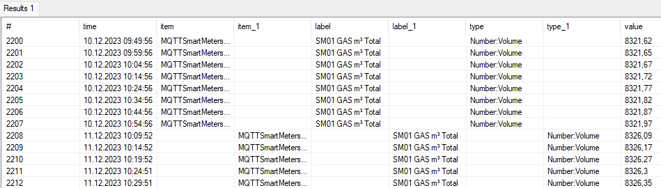

Well after some testing - this isnt my problem, unfortunately…
I used InfluxDB Studio to look inside database and found that i did something wrong while importing the old data. So current data is stored in item_1, label_1 and type_1 while old, imported data is in item, label and type:
So now i have to figure out how to move that data to the correct place… wonderful :wink:
