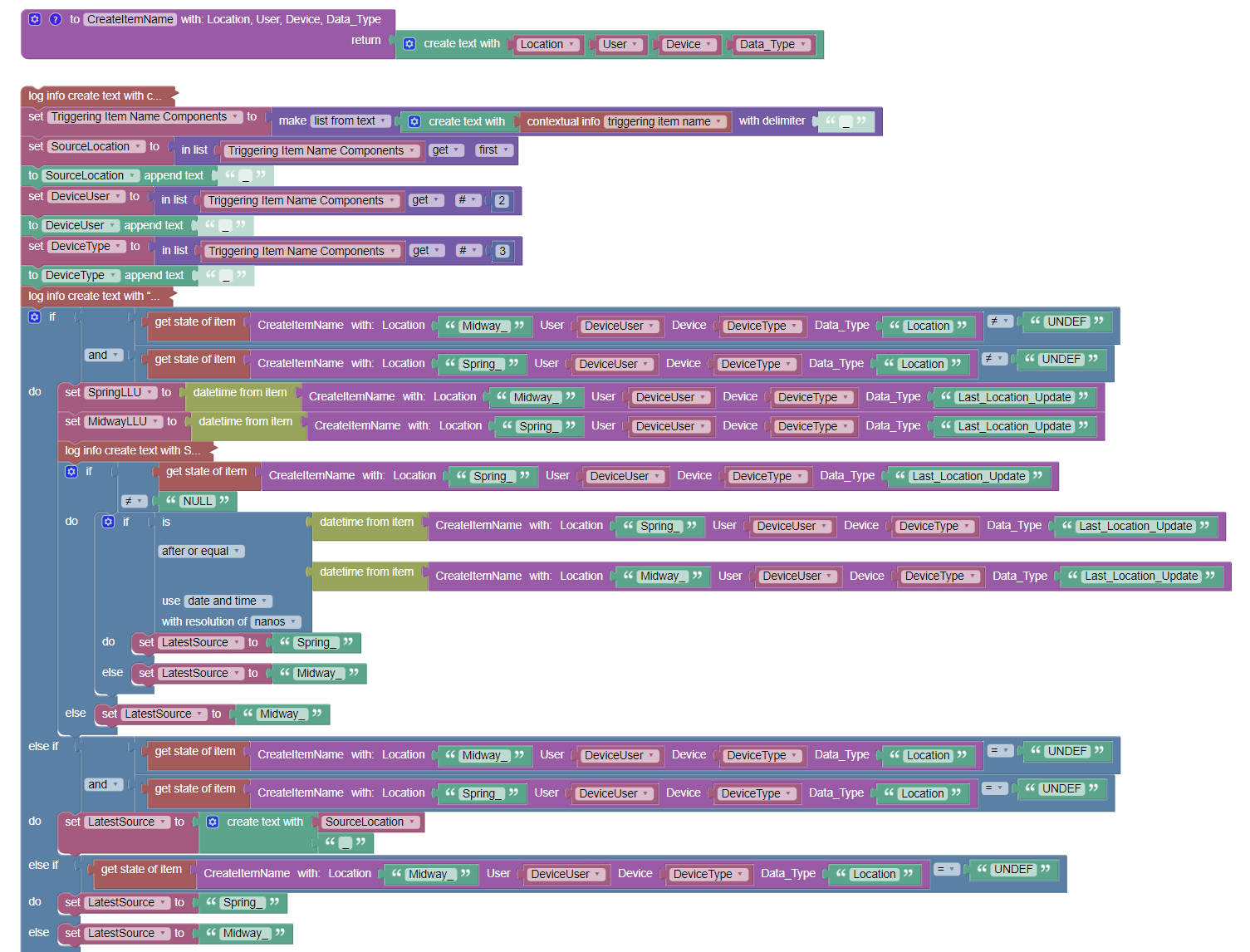

I take it the system is unhappy with how I am providing it with Datetime information.
It used to work using the “get date time from item” block. I’ve tried switching to the “date time” block, but still get the error.
Here is the script generated from Blockly:
var Location2, User, Device, Data_Type, Triggering_Item_Name_Components, SourceLocation, DeviceUser, DeviceType, SpringLLU, LatestSource, MidwayLLU, Suffix;

Here is the Blocky image:
The rule is triggered whenever an iCloud device location changes. The item names are built from the user (me, my wife or my daughter) and device (iPhone or Watch). There is also a Location component. I have two openHAB installations that are 1500 miles apart, and the iCloud binding runs on each of them, and using the remote binding via Tailscale, the iCloud information is shared. This results in more frequent updates than the 5 minute minimum for iCloud, and a back up if iCloud fails on one system but not the other. (For some reason, it seems to be more stable on one than on the other). The function defined at the beginning builds the item name from information in the item that triggered the rule. The rule selects the most recent information to use.
Any suggestions? Thanks.

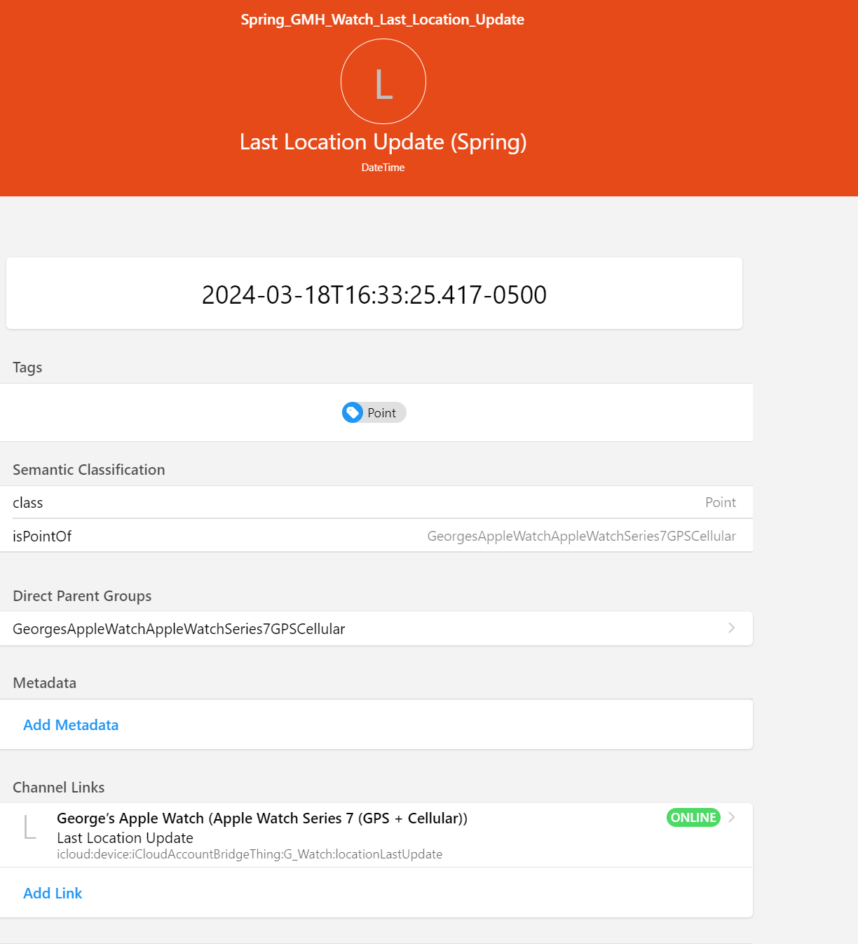

What type of Item is this, a DateTime Item or a String Item that has a date time formatted String?
Have you ever installed the openhab npm module manually? Do you see $OH_CONF/automation/js/node_modules/openhab or $OH_CONF/automation/js/node_modules/js-joda folders?
The items are datetime. Here is the code for one of them from the UI code window:
label: Last Location Update (Spring)
type: DateTime
category: ""

The rule still isn’t working, but the error message is different. It seems like the “get date time from item” block is unhappy with the item data that it is receiving:
2024-03-18 17:18:27.151 [INFO ] [iCloudDeviceLocationFromEitherSource] - MostRecentiCloudDeviceLocationFromEitherSource: Spring_GMH_Watch_Location
2024-03-18 17:18:27.165 [ERROR] [b.automation.script.javascript.stack] - Failed to execute script:
org.graalvm.polyglot.PolyglotException: Error: Failed to parse string Midway_GMH_Watch_Last_Location_Update (Type=DateTimeItem, State=2024-03-18T16:14:48.984-0600, Label=G Watch Last Location Update (Update), Category=, Tags=[Point], Groups=[RemoteopenHABServerMidway]): DateTimeParseException: Text cannot be parsed to a Duration: Midway_GMH_Watch_Last_Location_Update (Type=DateTimeItem, State=2024-03-18T16:14:48.984-0600, Label=G Watch Last Location Update (Update), Category=, Tags=[Point], Groups=[RemoteopenHABServerMidway]), at index: 0

There was a bug a little while back where time.toZDT was failing to convert an Item but that was fixed before 4.1.1 I think. This is all very odd. It’s doubly odd that the error changed.
But the work around for the old bug was to use the Item’s state instead of the Item itself. Where you are currently using the “datetime from item” replace that with “datetime: string” block.
And pass to that the result of the “get state of Item” block. The state of the Item is a string and time.toZDT() can parse that.
But this is all still really weird.
Thanks.
This worked
I agree that it is weird. With the advantage of your suggestion, I believe this (or something like this) is how I did it before the “datetime from item” block was fixed and I simplified my blockly with it.
I was going to try a clean new set up, but ran into a problem where my backup file is to big for the root disk to restore and haven’t had time to troubleshoot that. When I do, I will see if a clean system makes the problem go away.
