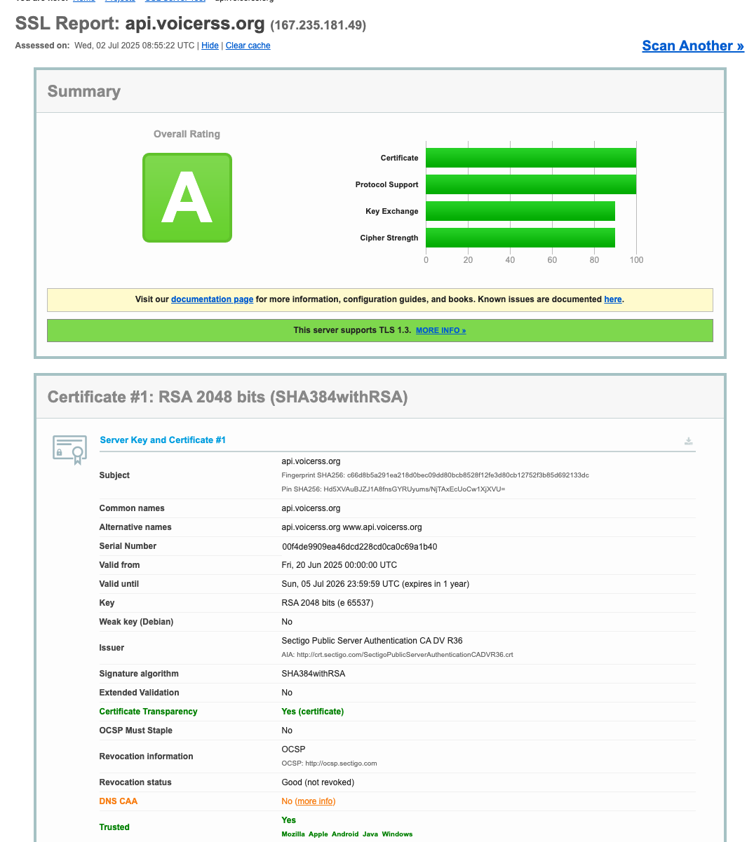

SSL certificate is fine:
An outdated OS/Java on a computer may still not trust the certificates. It won’t use that website to check the validity. :wink:
